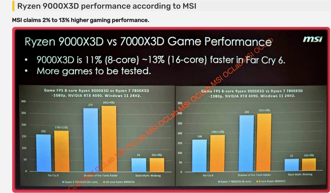

In any workloads. Probably over 20% in many situations.
Unlikely for the main use case which is gaming.
That graph is seriously dodgy, it lists 9000x3d not 9800x3d, and if true means zero difference for anyone 1440p and above where cpu matters less and less, 1080p is where the processor matters more

Just 3 games and one looks really GPU bound and 5090 probably will help
I just don’t see how we can expect a large uplift when we already know the vanilla zen 5 didn’t deliver much extra over Zen4, for the 9800X3D an extra 2-300mhz on the boost clock may add another couple of percent but I’d be surprised if in the end it’s more than a 7% improvement over the 7800X3D.
