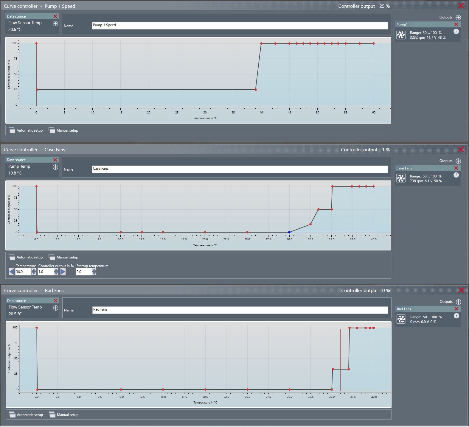

As for curves on pumps (or fans for that matter), test what sort of temps you get running at different speeds. You may find that your real-life temps don't change that much with pump speed so you may as well run it at a speed that doesn't cause offense to your ears. Personally I have my 'curves' set as steps for this reason. A constantly changing pitch is very difficult to tune out and is constantly distracting. If it stays the same pitch and only changes when you do something like start gaming (with higher temps caused by graphics card starting work) then you may find it less intrusive. My stepped curves start at 'off' for my rad fans (I have a ridiculous rad), spin them up when it hits a certain temp and stay on until it drops a full degree below the start-up point. This is done by having the "startup temperature" set in 'manual setup' to a temperature higher than beginning of the first step. All of these curves then have a final 'panic mode' for full speed at temperatures slightly above what I normally get to when gaming.
The slight slope on the vertical of the 'step' stops it from warbling as it gets to the threshold.
The vertical red line is the startup temperature.
Hope this is of some help/interest.
