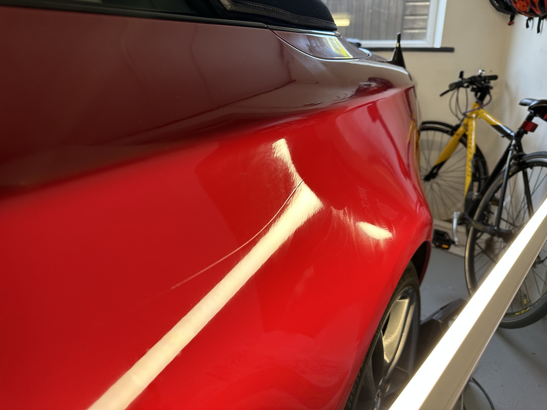

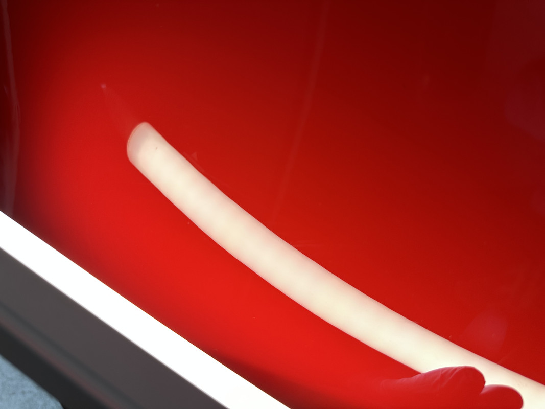

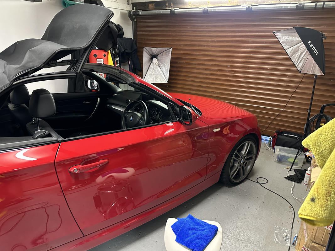

So a couple of weeks ago I took on the task of doing a full machine polish and ceramic coat on my 135i.
It was quite a monster of a task, as there were some hefty scratches on the car, but I've removed the majority of them. The deepest of scratches I haven't been able to remove, but I have been able to make them less visible, since the action of polishing removes the harsh edges of a scratch and makes it more shallow.

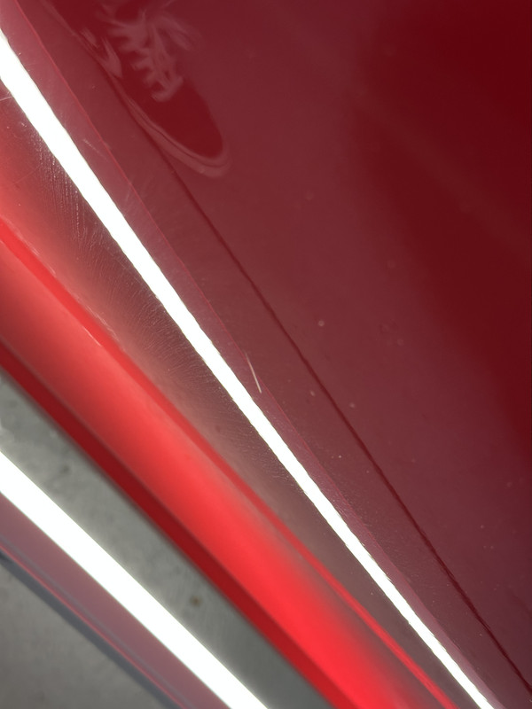

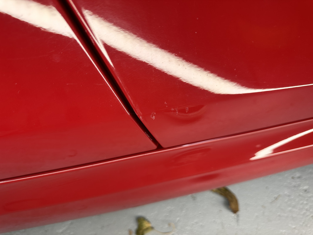

One thing I did notice during the process, though, is that the car has been resprayed at some point - and it has been done poorly. The body work hasn't been prepped properly, nor has the paint been allowed to dry properly.
Consequently, the car has some very obvious fisheyes when looking closely.
But the car looks really quite good with some great beading.
Took me 2 full days of prep + polishing.
I used:
Lake Country Manufacturing Microfibre Cut + Finish pads.
3M Fast Cut Extreme / Koch Chemie Heavy Cut H9.02
Gyeon G3 Finish / Koch Chemie Micro Cut
CQuartz UK 3.0
Gliss V2
