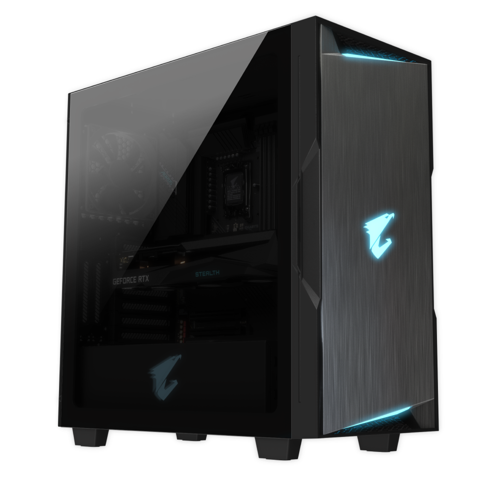

I think the whole PCI-E setup needs revisiting and redesigning.
It would be nice if GPUs pulled all their power from the PCI-E slot with extra power connectors plugging into the bottom of the motherboard.
This would make cable management much neater with much shorter cables going from the PSU to the edge of the motherboard.
I don't see why this could not be done as I have run CPUs that pulled more than 600W when overclocked.

The mac pro 2019 use's no power connections for the GPU's its all pulled direct from mother board like the W6800XT duo 2 x 6800xt GPU's on one board, and you can run 2 of them cards side by side with infinity link so 4 6800 gpu's all pulling power direct from mother board no wire connections at all.

The whole inside of PC cases need a redesign starting with the motherboard
It would be nice to see a separate thread about this with a poll.
It would be great to see people's views about what they think needs changing and why.
i always thought of moving mobo cmos battery to case, just for easier replacement.. so maybe youd have a cmos battery hub near the power button/topside and then it powers the thing though wires connected to the mobo
