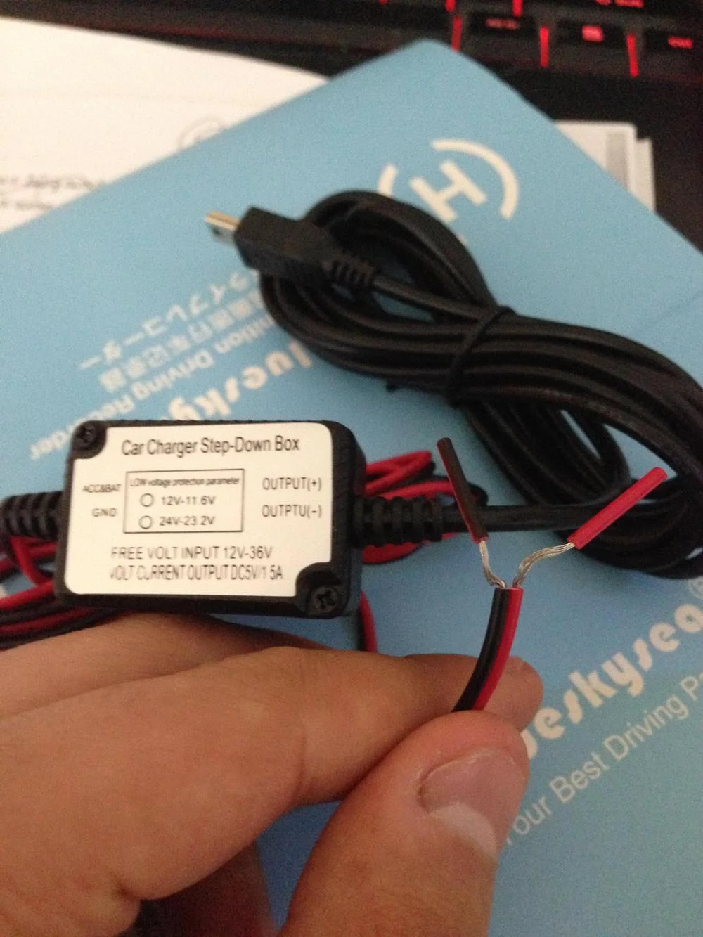

Cheers, so would this be good enough?
http://www.ebay.co.uk/itm/ADD-Circu...207455?hash=item339e1faa5f:g:cYAAAOSwl9BWHoJA
So basically all I need to do is remove the fuse for the cig lighter from the fuse box, plug this fuse tap in its place and put the original fuse back into the fuse tap?
Then with the kit in the picture I put above, one wire to the fuse tap and one to a ground (any bolt near the fuse box).
Yeah my fuse tap is exactly like that. Two fuse slots on it - one is for the original fuse, the other is for your new power source. I just took out the original lighter socket fuse and slotted that into the top slot then popped a 2 amp fuse into the lower slot. Then I just spliced the 12v wire onto the wire from the tap and stripped a decent length of the ground wire off and wrapped it round a bolt.
With regards to fuses, as mentioned above, one is for the original fuse and the other is for your new circuit. Dashcams draw hardly any power at all (usually around 1 amp at 5v, so you're probably looking at 0.4-0.5 amps draw off your 12v) so use the smallest fuse you can get. I thought 2 amp was smallest but there are 1 amp ones after all.
Thank you! I'll get this ordered with a 2 amp fuse :)
