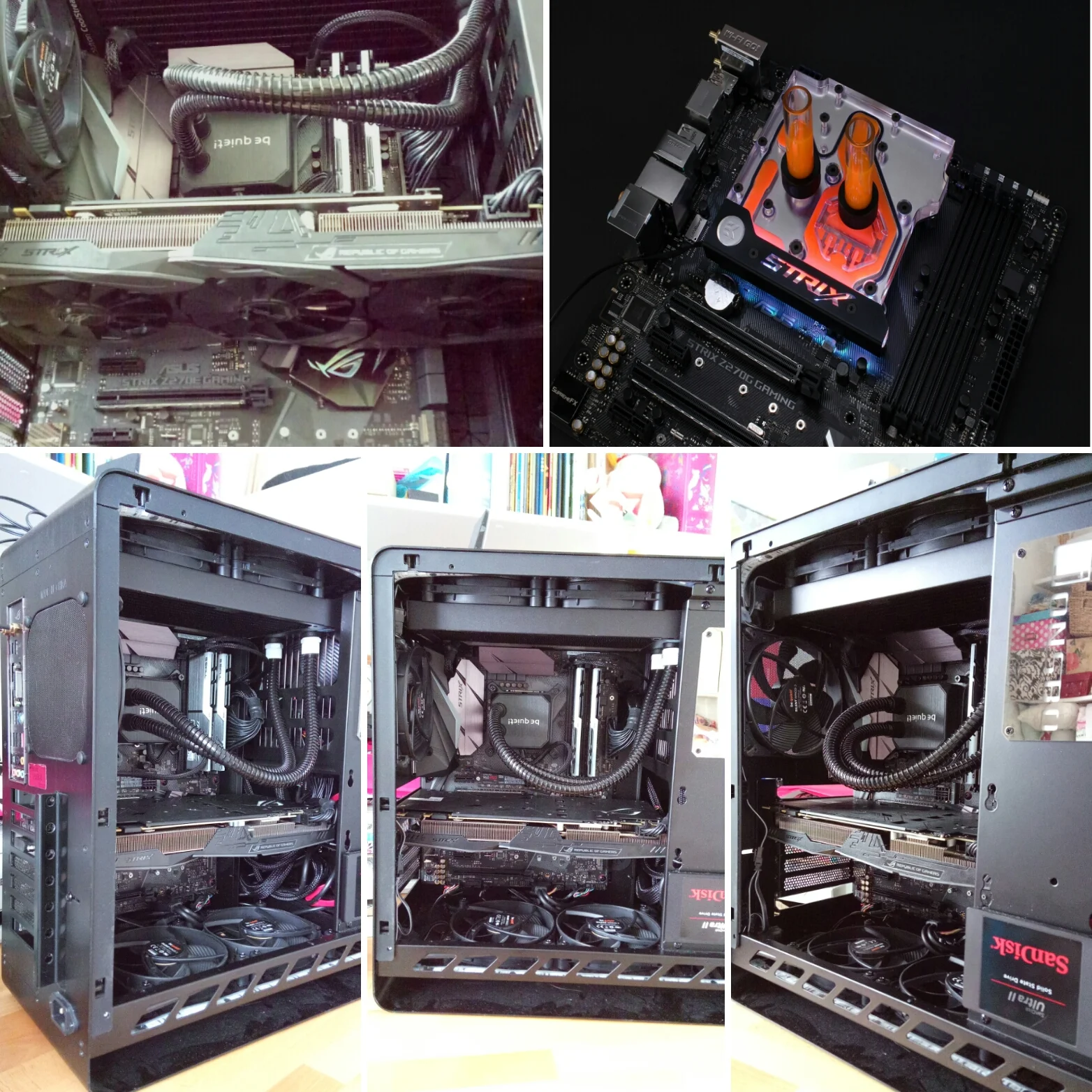

Phanteks Strix block has been shipped today, expect it to be mated to the board Tuesday and wet on wednesday
Temp sensor will be added to check water temp to see if fluid hits 32c or below. any higher and will add a 120 to the rear
then will pull the trigger on EKs mono block :D since the Glass Panel is black ***forgot to say recieved a glass panel! just the front ***.

Hoping I can get some solid camera shots of the block its self then installed Tuesday :)
will be taking out the Silent loop Wednesday, quick cut in the outlet tube to drain and hook up to the card. once installed. flip the case upside down and fill via one the GPU blocks bottom ports :)

Thought id get some decent pictures up before the Phanteks Strix block goes into the loop with the Silent Loop AIO, which wont last long as EKs mono block will be going in. Temp sensor will be fitted during the temp set up, hoping water sits around 32c max, if not i'll add another 240 at the bottom
Recently got myself a Hoya Pro-1 Digtal Filter in hope is makes capturing tempered glass and RGB cases more easier. Currently still plaing around but with the glass/see through panel off its better not to use the filter and it makes the RGB a bit flat
And with the filter and darkened glass panel on
Strix Mobo block should light up the dark spot in the middle just nicely with the Phantek block adding a nice strobe effect across the hard- least I hope the LED in it can mimic the rainbow effect of the IO/Ram.

I Present, Phanteks Glacier STRIX
one bad point, the finish on the contact side is poor... GPU raise you can clearly see the machining. Intels stock cooler has a smoother finish!
To lazy to polish the Die and Ram contact area but with the rest of the product and box looking above par, was really shocking to see!
BUTT CRACK^^^ feels real good too :(

will be Thursday earliest I can get the card plumbed in, see how the temps do and the contact with Grizzly paste is
thought i'd post a quick snap of the Phanteks Strix block on the card.
got digital snaps but will be end of week before uploading
should be a tight fit, but hoping to cut the outlet hose (closest to camera) and attached outlet to the inlet of the GPU, which is on the left side. The use a 45 to connect the hose going to the rad. going to be tight but is a stop gap till I can get EKWBs strix block in .
will just fill by turning upside down and filling up by one of the bottom GPU ports :)

so OCUK sending out replacement Silent Wing 3 fan for the rad, currently only running on one.
Did quick bench with the one fan at max, 40C for the Strix @ 2155 & 55c for the 7600k @ 4.9, water temp is 32c
Lots of snaps!
Phanteks block on the Strix; Grizzy Paste and Pad 8 used!
Block Installed! flipped upside down and filled through bottom of the GPU port hole
