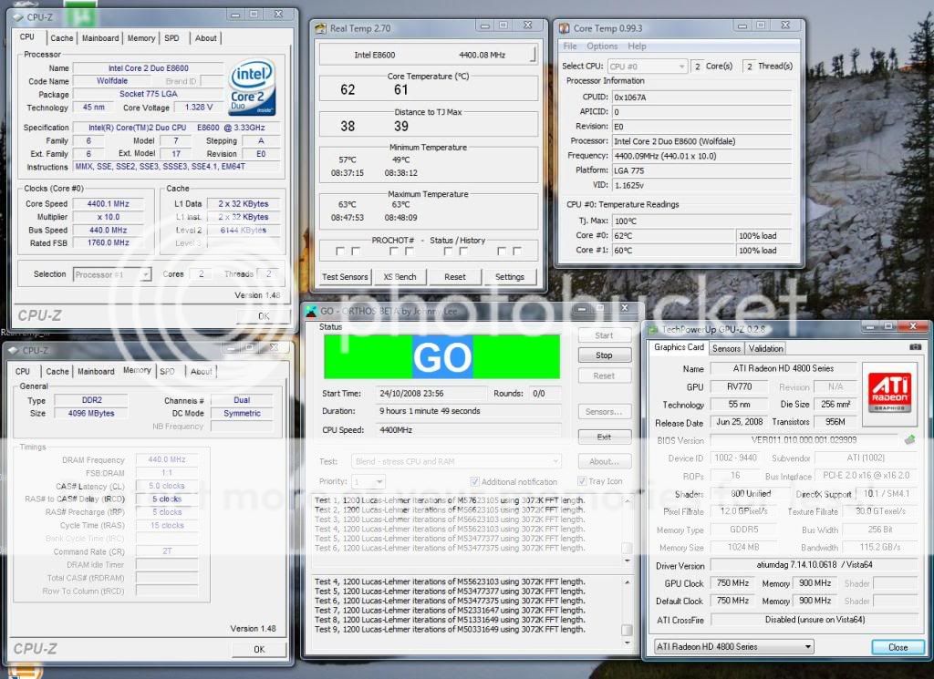

It was orthos stable using small FFTs test for 7 hours at 10x440 with vcore 1.35 but was failing the blend test after 2 hours :(
Up the vcore to 1.37 and its now stable :) temps are ok too.
Here's my database contribution:
Q822A435 ¦ 4400 Mhz ¦ 1.37v ¦ 1.1625v ¦ 62 ¦ OCZ Vendetta 2 ¦ Asus P5Q Pro ¦ arrond ¦
http://i378.photobucket.com/albums/oo222/arrond3/stable.jpg
Tempted to try 4.5 now :p

2 Oct 2008
127
<pic snip>
How come mine won't do that? Same Q822A435 as well and yet if I try anything over 4.35 I have to up the voltages to the point where it's 55 idle and jumps straight up to 75 and I instantly hit stop on orthos :mad:
Noctua NH-U12P with the paste that came with it. I'll try upgrading to a better paste I guess?
