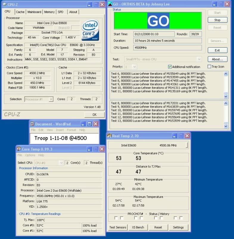

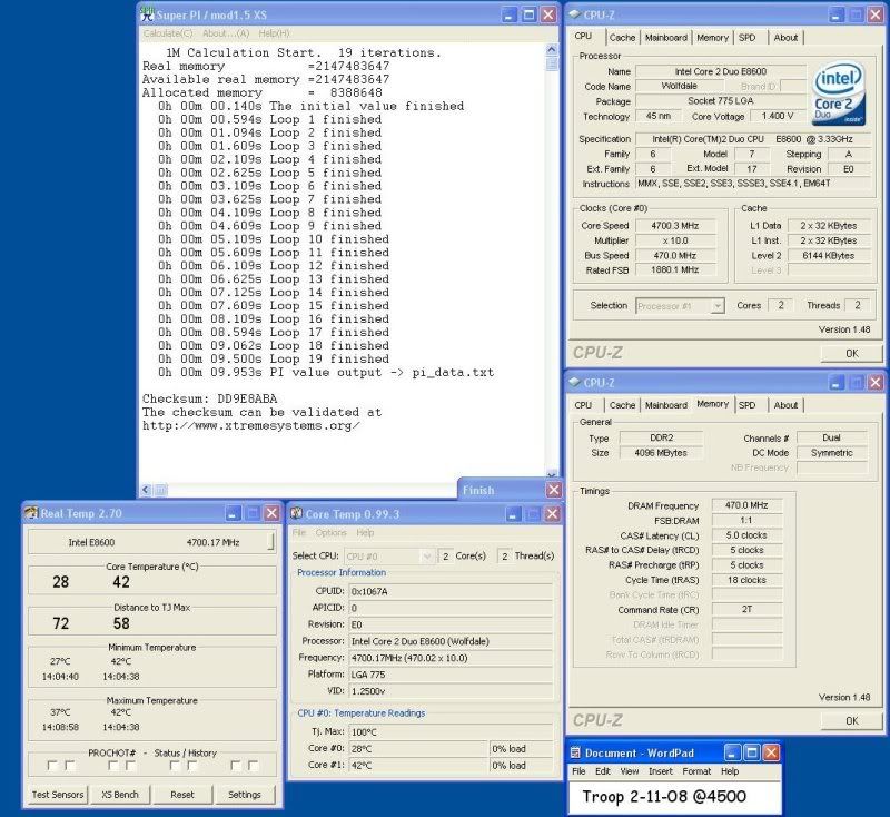

Had the 8600 installed since Friday night,
initial tests.
this run is @4700 super PI
Troop, would I be right in saying that fans on the rad are pulling air into the case? Because if it isn't then there would be a lot of backdraft coming from the floor with it being so close.
Yes, the fans are pulling the cold air off the tiled floor, through the rad, into the case, made it like this so I get the cooler air off the floor, and it works very well :)
