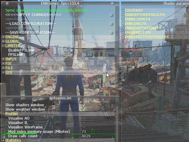

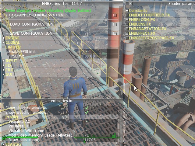

13700K (5.6GHz all P-cores, 4.4GHz all E-Cores, x49 Ring), 2x8GB DDR4 4100MHz 16-16-16-34, Gear 1, CR1, 1.56V, Patriot Viper Steel 4400CL19 - PVS416G440C9K), RTX 3080, Win11
Save1 (Corvega): 11687 - 123.8 FPS Save2 (City): 7962 - 153.1 FPS AVG: 138.45 FPS

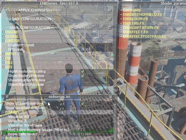

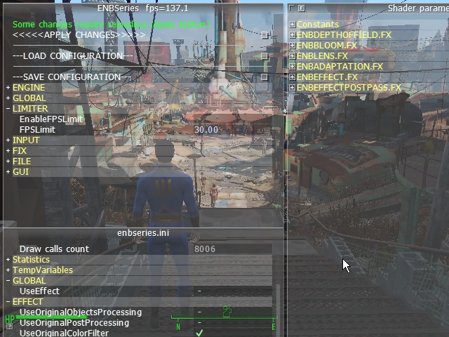

Not as fast as I'd hoped for but looking through some scores people have inflated or deflated numbers as every draw call counts, and being down by even 50 draw calls can mean 3 fps, just look at post #178 :
So for Windows 11, there's some settings to try in various combos.
The first one should be boosting frames for FO4 draw call test since it's in windowed mode?
Fixed the 11700 draw call test:
123.5 FPS
150.4 FPS
137 FPS AVG rounded up (136.95 FPS AVG)
Ratio 0.8211436170212766
