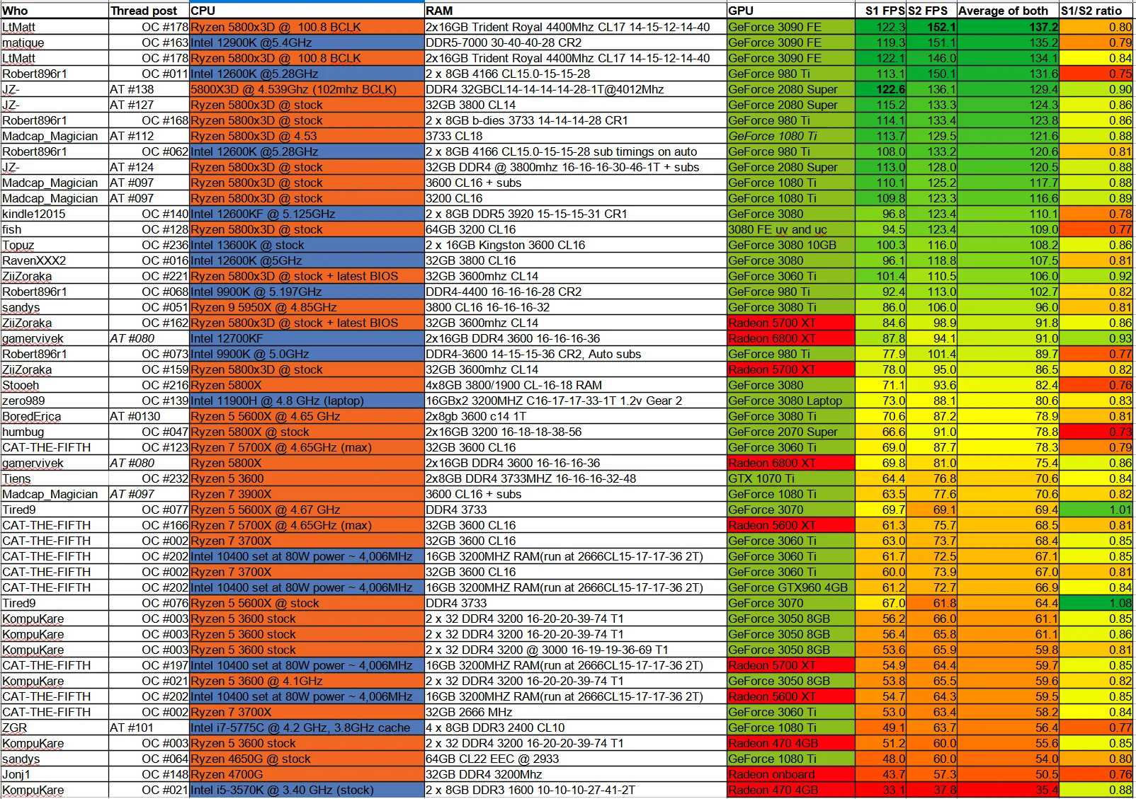

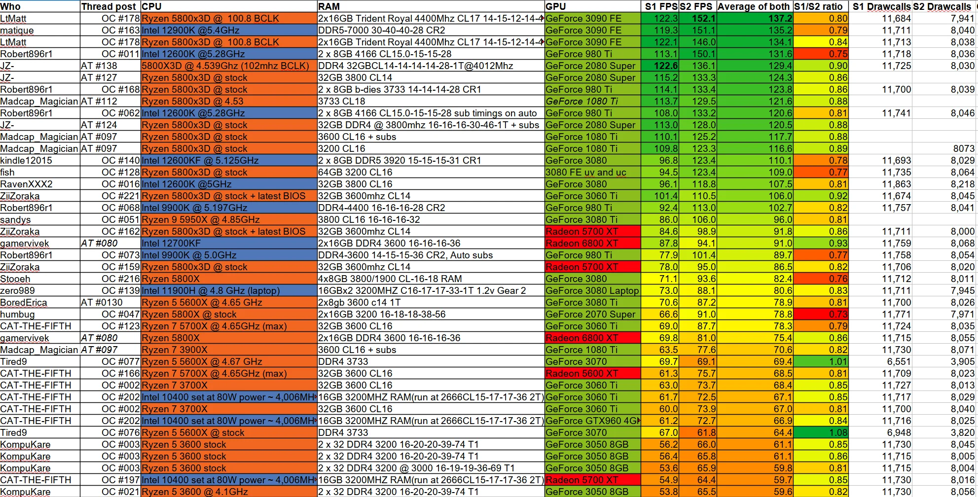

Updated scoreboard

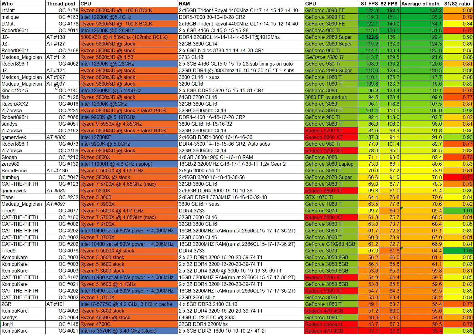

And here is your score added to the table (which really is getting far too long to attach as an image, but adding as a vbullten table would take forever each time):
There isn't much in it, but yours is the best scoring Zen2 CPU in the list.

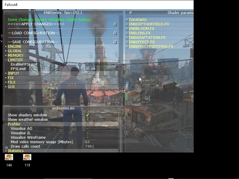

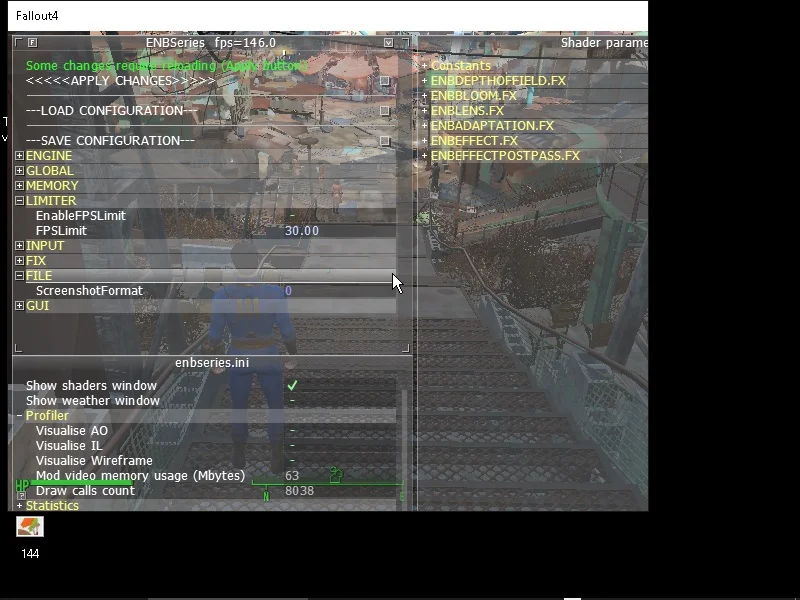

Hi all, was lurking here for a while, thought I'd contribute with my new 13600K. It's all stock currently with 2x16GB Kingston 3600MHz CL16 DDR4 and nVidia 3080 10GB.
Thanks,

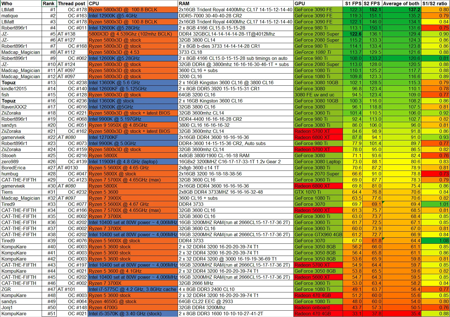

that places you at #15 just between a 12600K @ 5GHz and a 5800X3D @ stock:
(if this table gets any bigger I will have to put in a spoiler - or figure out how to paste it as a HTML table although I suspect that would lose me the colours - which have become a bit strong anyhow).
Still waiting for someone with Zen4 and RPL with extreme DDR5 memory tuning.

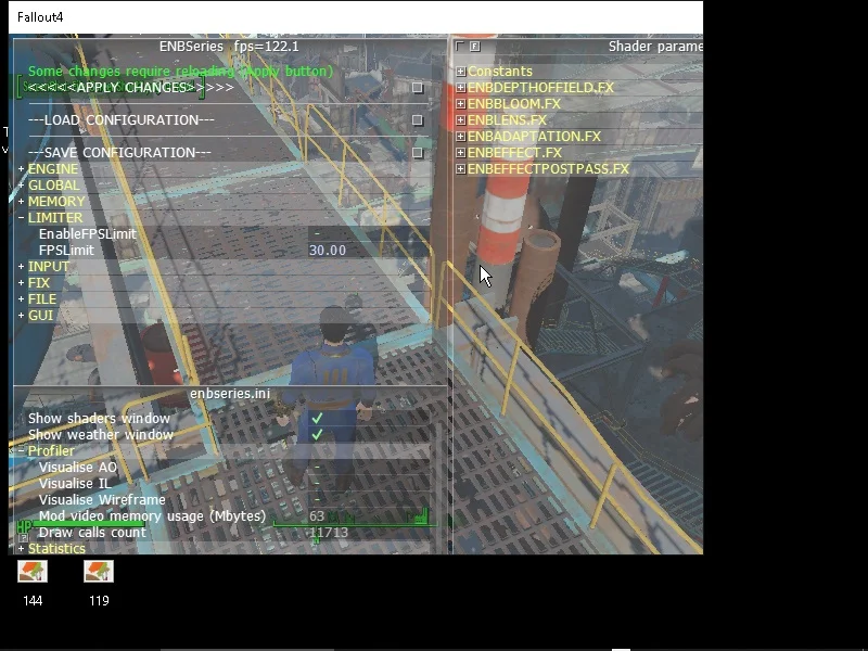

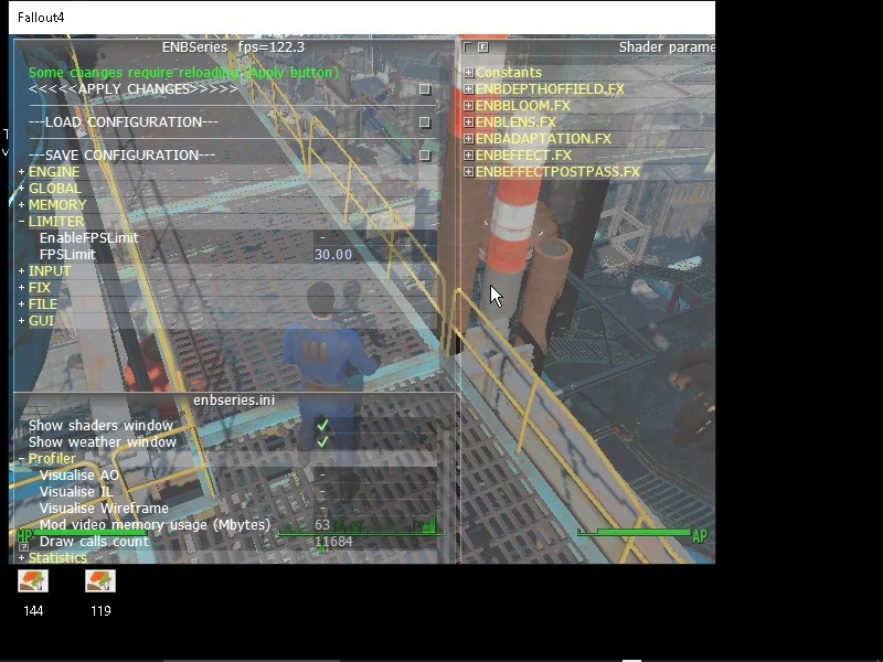

A small update with a mild overclock...
13600K @5.6GHz
2x16GB DDR4 CL16 @3800MHz
To be honest I expected a bit more, my very average RAM is probably holding me back. I didn't really properly stress test this so it might be unstable, I just wanted to see how it scales.

Here you go
So that has improved your position by 2/3 places.
As for how it scales, well with the same CPU memory seems to favour the town scene more judging from @Robert896r1 scores for instance the score in rank#019 vs rank #011. Same clock speed but while S1 gains 4.7%, S2 gains 112.7%.
While we cannot prove anything from that, S1 is more drawcall, while S2 is drawcall plus AI. So maybe the AI thread (note the singular!) really appreciates the memory speed more.
