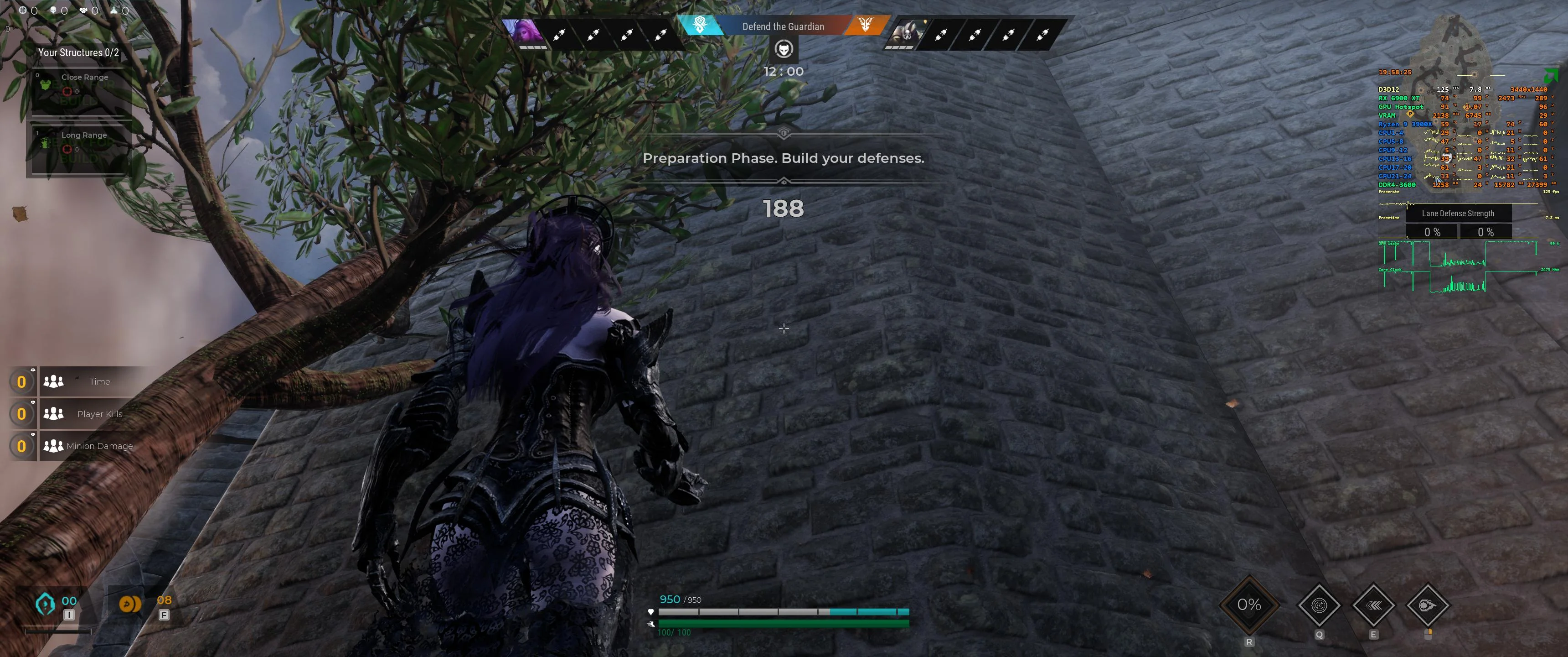

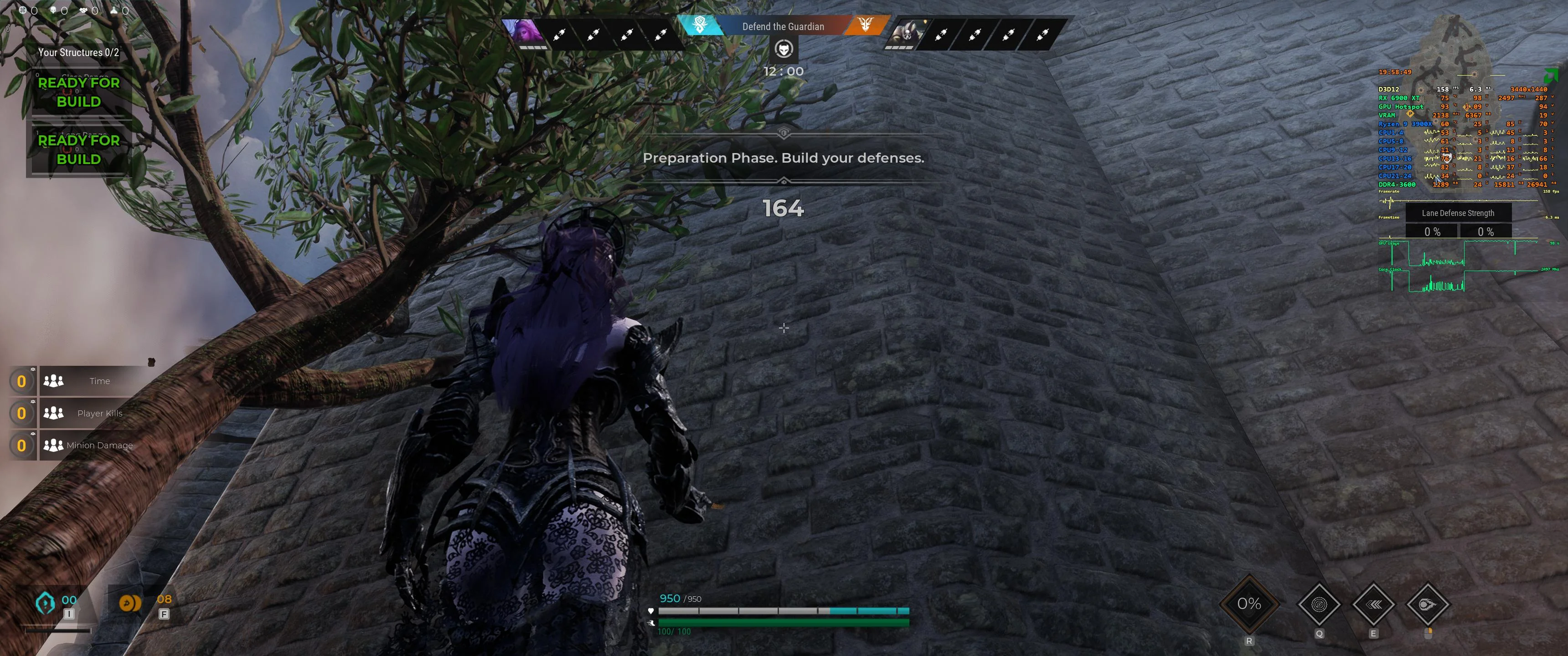

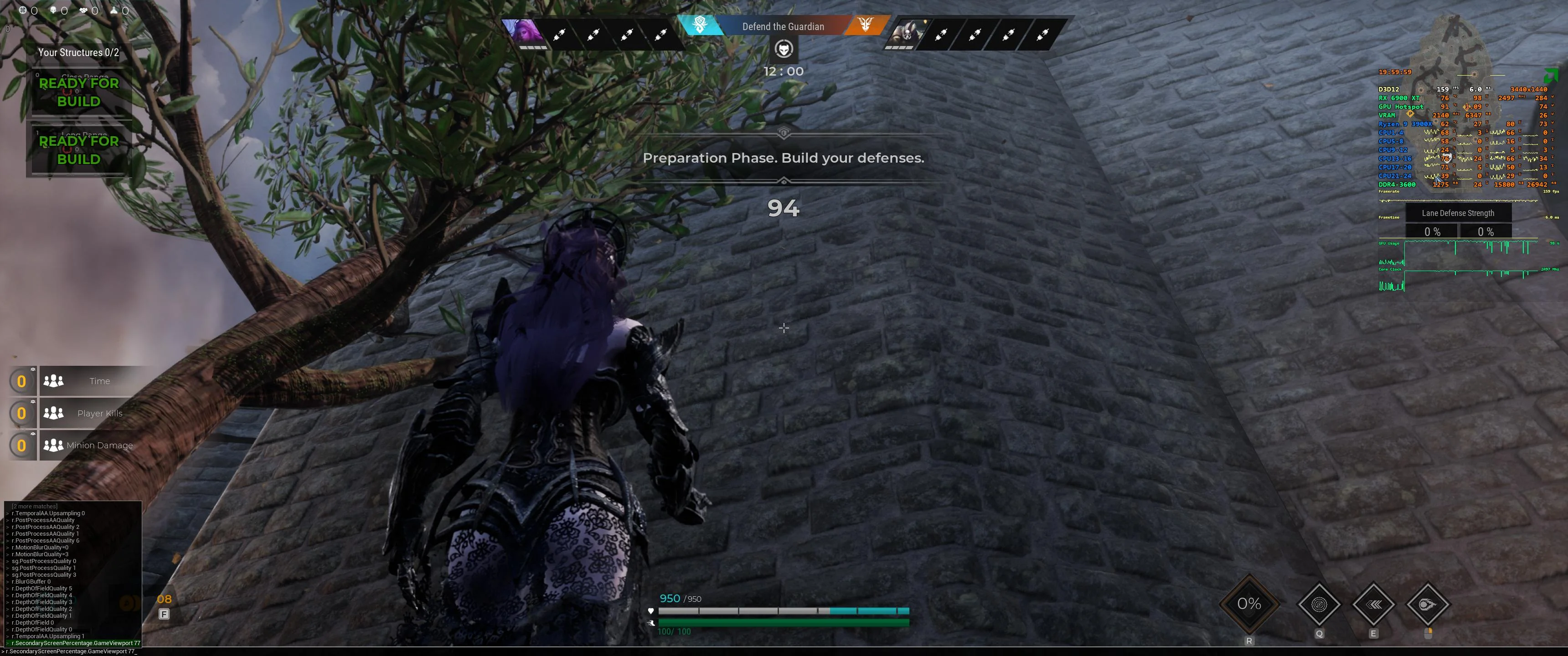

Are you still hanging on to the DF fake information regarding FSR/TAAU? In case you haven't noticed DF have been debunked and it has been proven FSR is better.
https://www.reddit.com/r/Amd/comments/o6skjq/digital_foundry_made_a_critical_mistake_with/
The TAAU shot is blurry compared to the other two.
