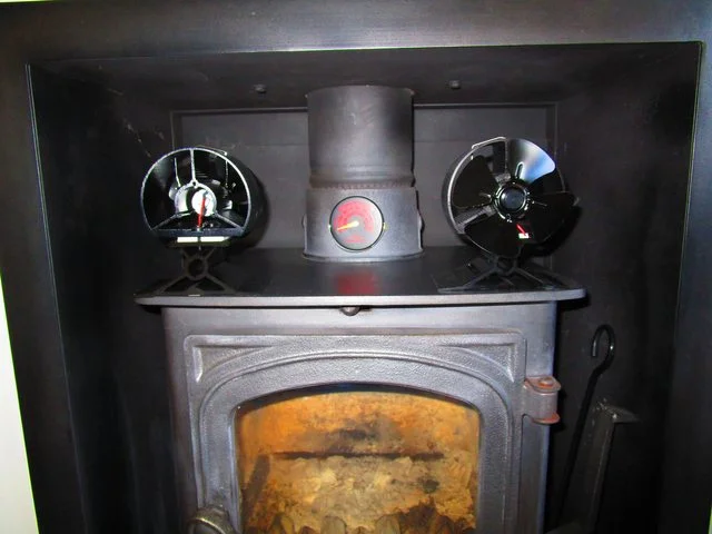

Lit the log burner tonight - It's not been on since chimney was cleaned so giving it a try - Also I bought a fan months ago so needed to see if that worked - It's only a 4" fan as I only have 7" headroom - very surprised at the amount of hot air it is moving and how soon it came on - around 100C.
Just going to order another for the other side of stove - They should make a noticable difference.
PS. would you believe it - Sold out! -- Found it -name change to EcoFlow mini

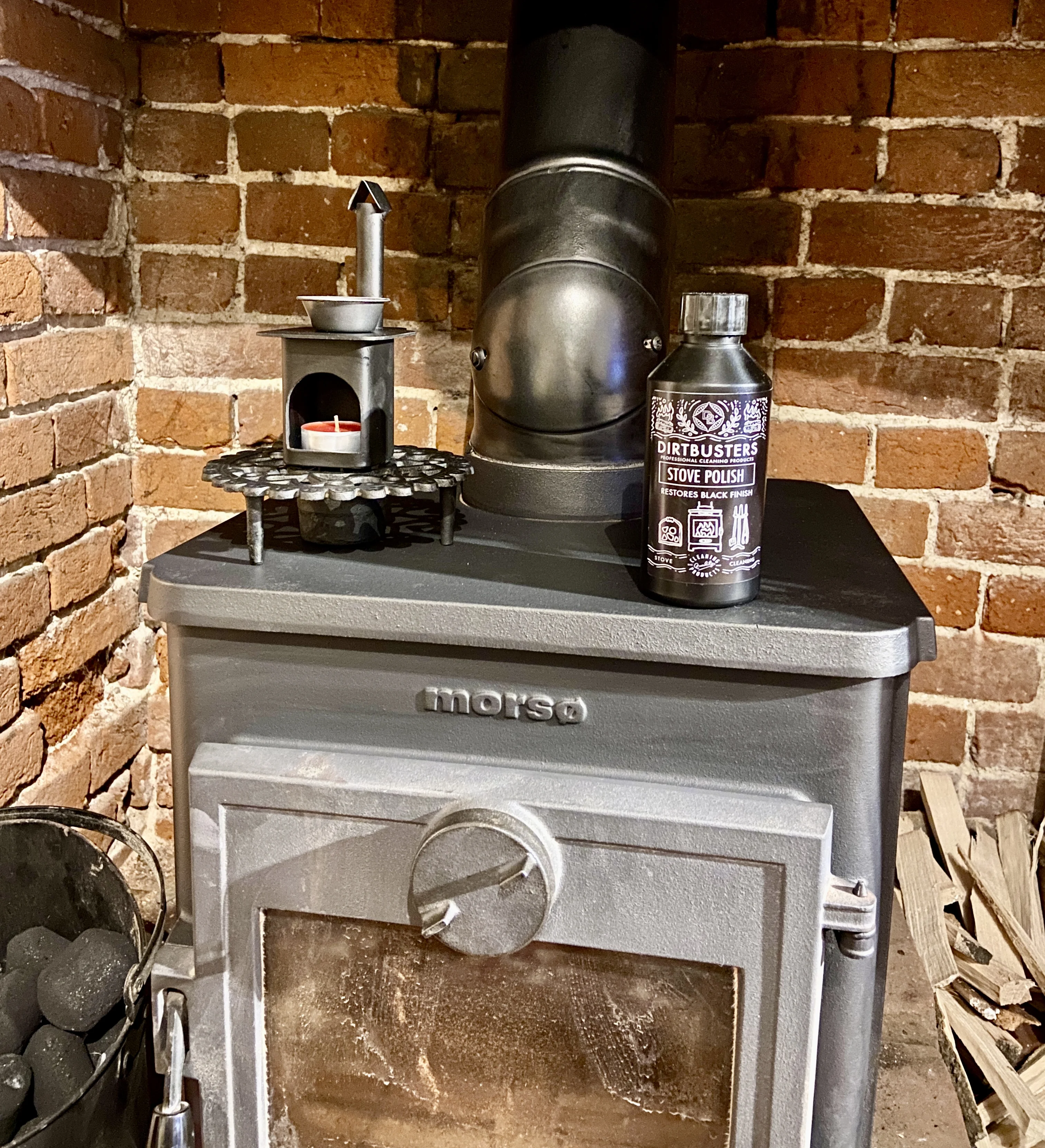

Decided to give the stove a clean and fit a new rope to the door before it's running 24/7 this winter.
Dirtbusters stove polish got some decent reviews and after a thin coat (I'll do another) over the main body it looks pretty decent.
I'll fit the rope tomorrow and do the same to the door..

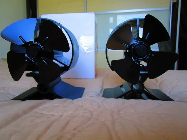

This is Fred and he has done two shifts this week and thought it was a struggle for him so bought him a mate
Meet Freda.
The fire was on it's last legs last night but Fred was still pumping out hot air - Very impressed with them.
The black hole
That by the way that is a steel box the fire is sitting in - Over the years on all the other stoves the surround has cracked even though it was asbestolux - Only regret is not knocking out a bit more of the chimney breast for a bigger box - but it is fine for our small lounge.
When this was up and running the first time we noticed the wall behind the fireplace (in dining room behind) was getting quite hot even though the gap between box and brickwork inside chimney was filled with vermiculite and above was filled with cement/vermiculite mix.
Unfortunateley the builder put 8" crock chimney liners upside down so eventulally we had tar water coming down side of chimney wall.
Out it all came -Flue liner installed and all put back and no more tar water.
One other thing I did was get a sheet of metal and fix it to back of box (you can see a line level with top of fans) Left a gap top and bottom - also put vent into dining room so now no hot wall behind and nice warm airflow due to metal plate heating up and convecting air from vent tube and from vent in floor under the stove.
