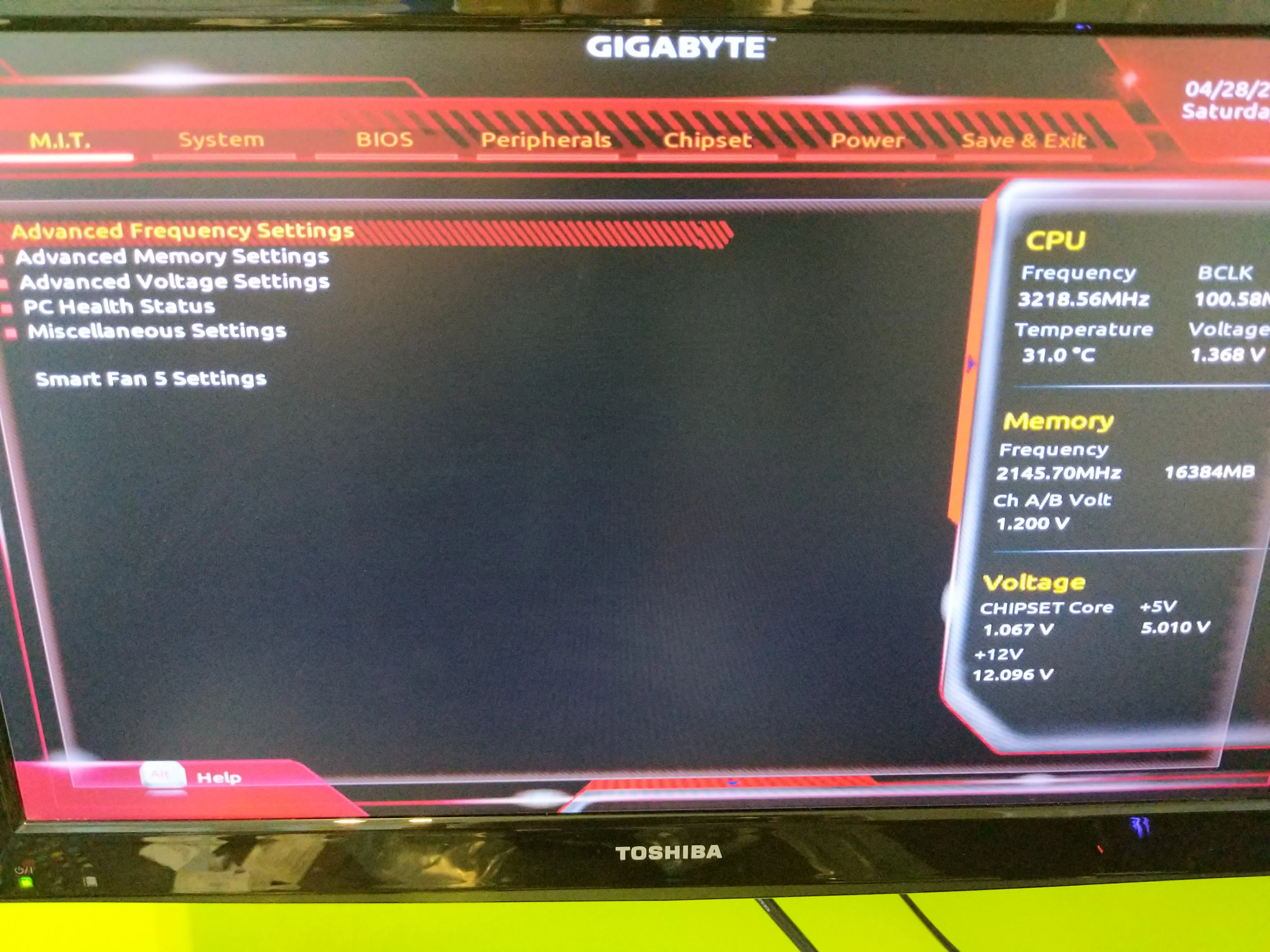

Also if doing clean install of Windows, leave all settings to default . Then you can go back, enable XMP for ram and play with ryzen boost settings etc etc

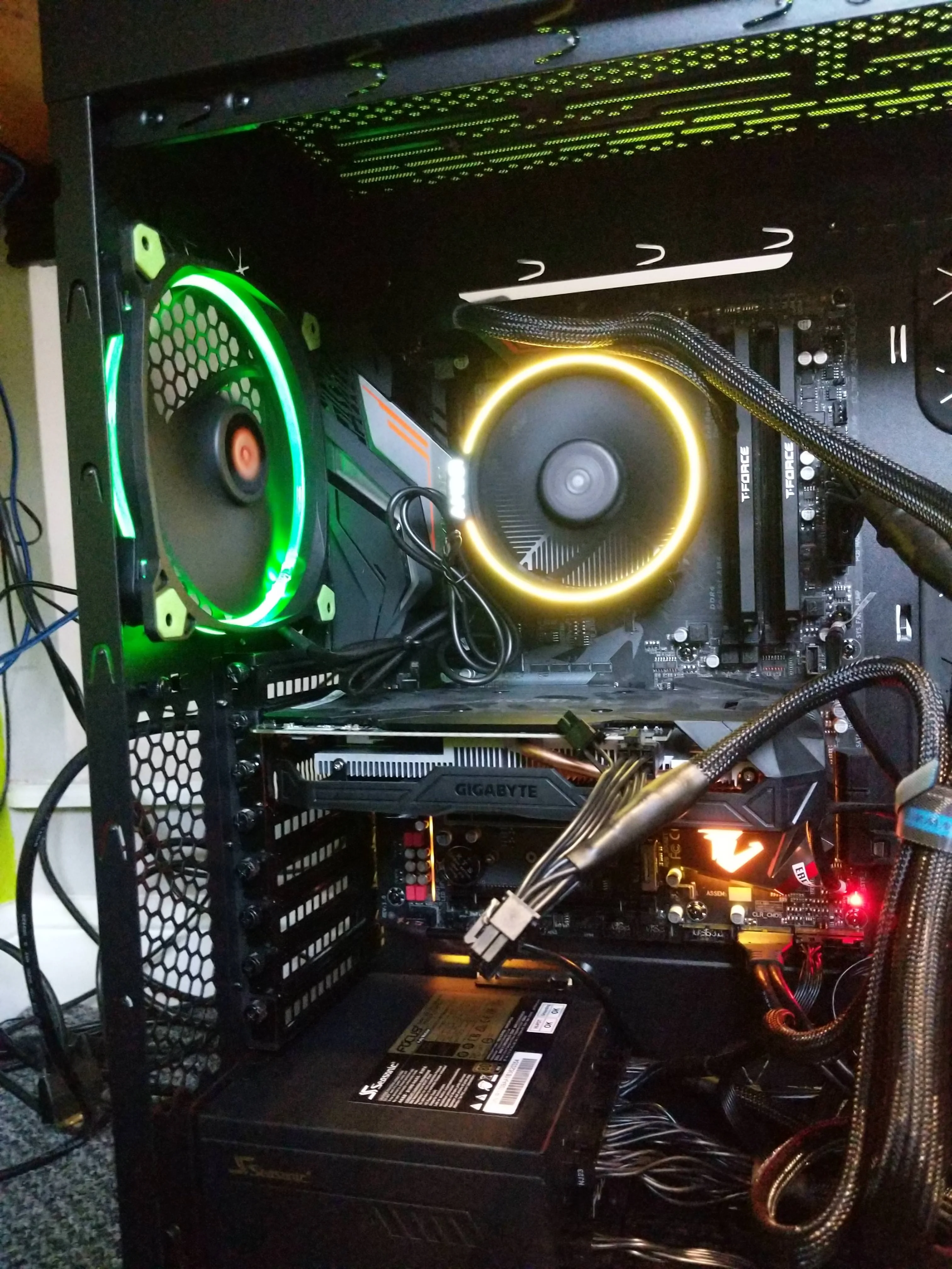

Those front panel cables are a ******* to get in. It also doesn't tell me which side is positive on some of them so I've just gone with writing on the top is correct way up
Also a red light on motherboard bottom right, is that correct?
Edit: read manual, no operating system, all good!
Only other thing is the blue power light on the front flashing, that doesn't seem correct
Some reason , when installing windows , it restarts it's it's and if you make the USB boot stick the main boot drive, you can sometimes get caught in an install loop. I tend to leave Drives as main boot, but when splash screen appears " screen where it tells you to press delete for bios and other options. I believe F12 allows you to boot from a selected drive.
Select your Windows USB stick and will boot and launch windows :)
Well done ! And will look good once lighting is all set to green :)
