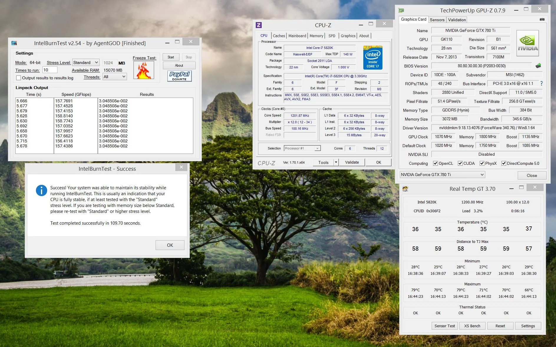

Found the sweet spot for my setup.
Leave all settings on default 'Optimized'.
Then change all cores turbo to > 4.4Ghz.
Then just set voltage to 'normal' +0.0200v.
Gives up to 1.35v.
No need to change anything else !

IntelBurnTest all cores under 80c.
Gives up to 1.35v.
Awesome :D

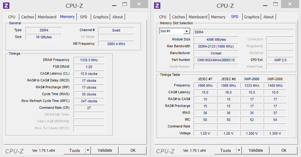

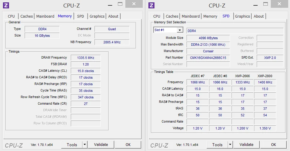

Boom what's your ram running at? You using xmp profiles?

Seems to like the memory at default setting rather than XMP.
