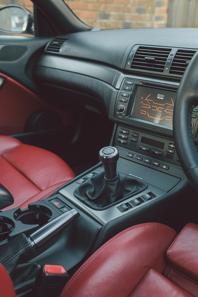

It's their own launcher, I don't use it and instead installed Nova Launcher as that is what I have on my phone and share a common homescreen gesture configuration so everything is launched via gestures as opposed to onscreen buttons. Keeps it all clean, old pic below but same on the new AVIN:
