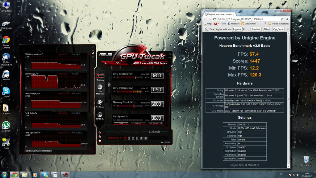

Thank you guys, i was lucky enought to find this forum, and it was clear for me I had to buy this card for my first new pc desktop.
Here its my contribution. From a newbie.
Sapphire 7850 non-oc edition
Cheers form Portugal
Where did you get that desktop wallpaper from mate?.
