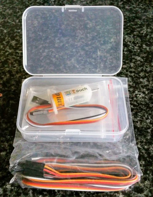

A BLTouch auto level (arduino and some dupont connectors as well to flash bootloader) and some borosilicate glass otherwise you're going to be very frustrated with levelling the bed every single time you wish to print especially on long prints because the bed you get goes to **** after a few days of printing, probably some spare nozzles too

Is it difficult to install the BLtouch? It does seem really handy. How does it actually work? Do you just level your bed once, and then it fine tunes by actually working around any wonkiness while it prints?

It's difficult if you're not technical but it should be easy enough for people who frequent an overclocking forum
I bought the Chinese version as it's $14 and basically the same
dont you loose microsd functionality?
