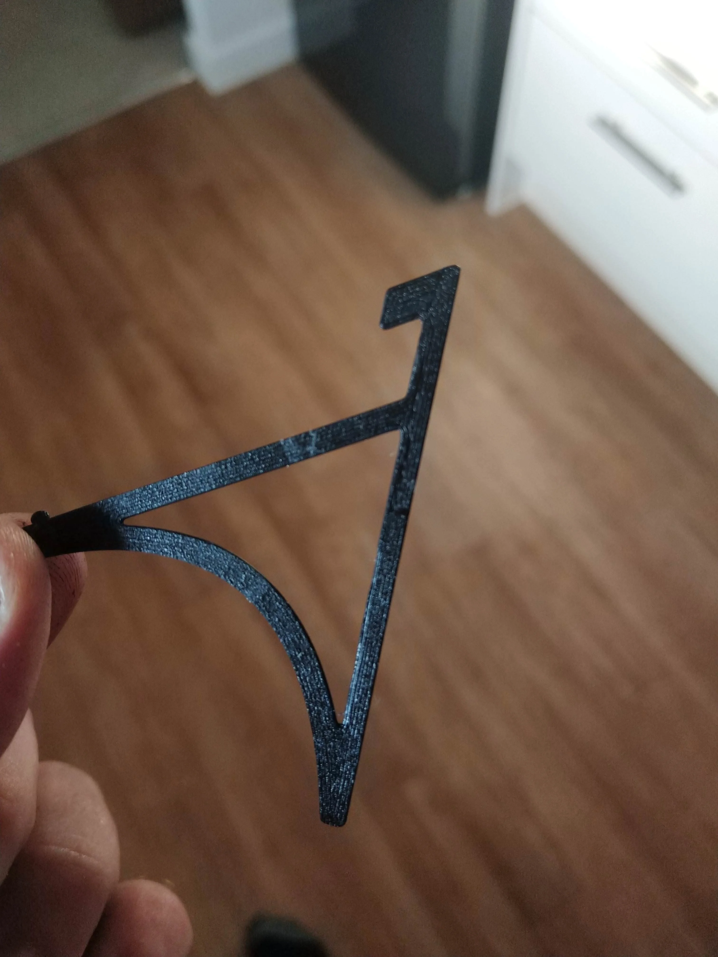

I got me 3D printer, awesome!
Are you checking for level in the centre of the build plate as well as the edges? Most platforms aren’t level and naturally most people check for level in the corners which are often higher than the centre where most parts are printed
Levelled at the corners then approx 100mm from the corner, bed has very little warp checking with a straight edge. I do
Latest Cura using the CR10 Profile with adjusted bed size as that's what a lot of people seem to suggest for getting started.
Try moving the nozzle to the middle of the bed as you sometimes get gantry's that aren't flat which can raise the nozzle in the centre of the bed. I've tried all sorts of different methods to set the nozzle height but the best I have found is setting it visually. I shine a light behind the nozzle and set the height so there is a slight gap, moving the nozzle round the bed and trying to find a bet fit scenario.
I'd hazard a guess that the nozzle is too close to the bed looking at the pic which causes the issue of no filament being extruded which leaves gaps in the bottom layer.
4 layers at the bottom is more than enough, you can get away with 2 layers no problem.
Temps I use are 55oC for the bed and 205oC for the extruder.
If you take a video of the first layer being printed and post it up here (dropbox type link maybe) I'm sure we can work out what the issue is for you.
Think you might be onto something there, first layer is almost indistinguishable from the bed.
Will relevel it around the center this evening.
Edit: levelled the bed from scratch again and ended up going backwards, bought it up a touch and improved then (Wrongly or rightly?) increase initial layer height from 0.2mm to 0.3mm and ended up with the below result.
Very nice. I suspect increasing the layer height moved the nozzle further from the bed which made the difference. I find layer height to be very sensitive, once it’s dialed in don’t touch it!
Sometimes I print a 100mm cube and visually inspect the first layer to make sure it’s even, adjust and reprint until it’s sorted. With the cr-10 and big levelling knobs you can do this on the fly, not sure about the ender but I think you can get in there.

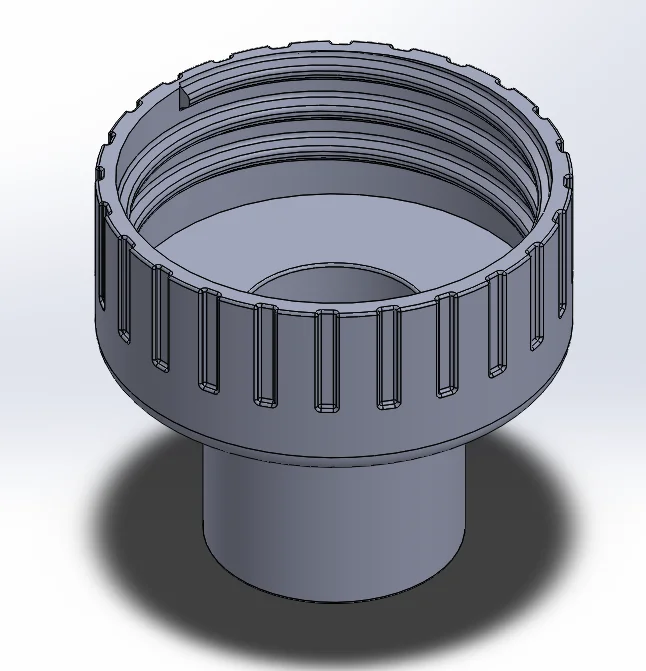

An adapter for 5 litre cans to allow me to put a hose on the end to dispense from them (Pic below of the CAD model in Solidworks anyway) (Screenwash type 5 litre cans)

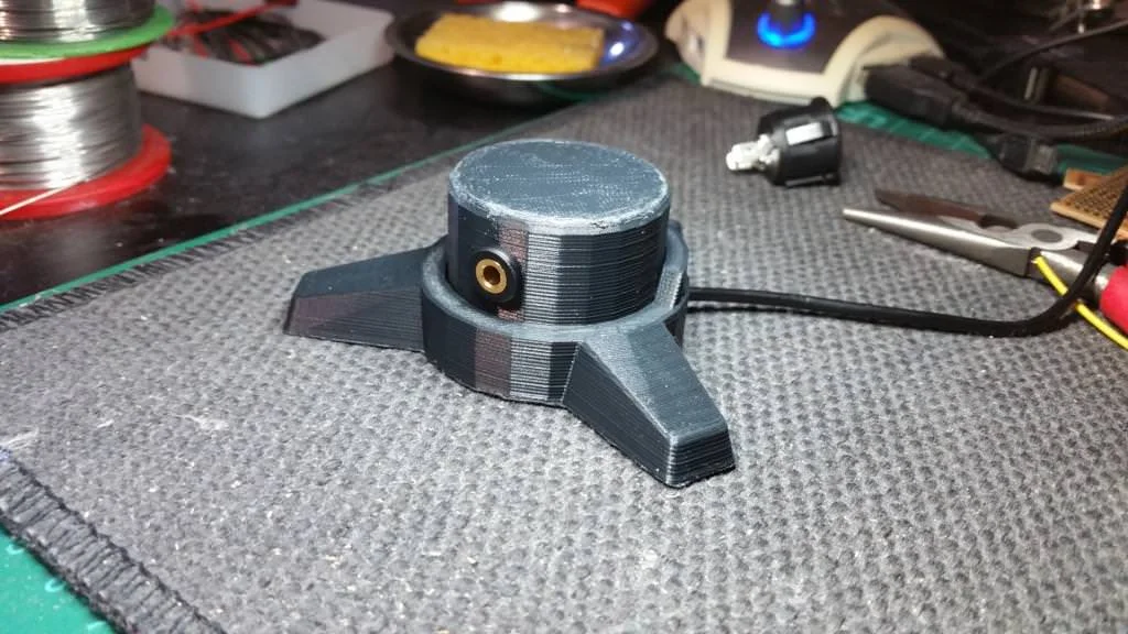

Printed myself a little headphone extension dongle thingy
Needs a lot of polishing and a finish but that is a job for another day - the layers don't show up anything like as obviously to look at the lighting/camera seems to have emphasised them.
I probably should have created the mesh in a bit higher resolution as well.
