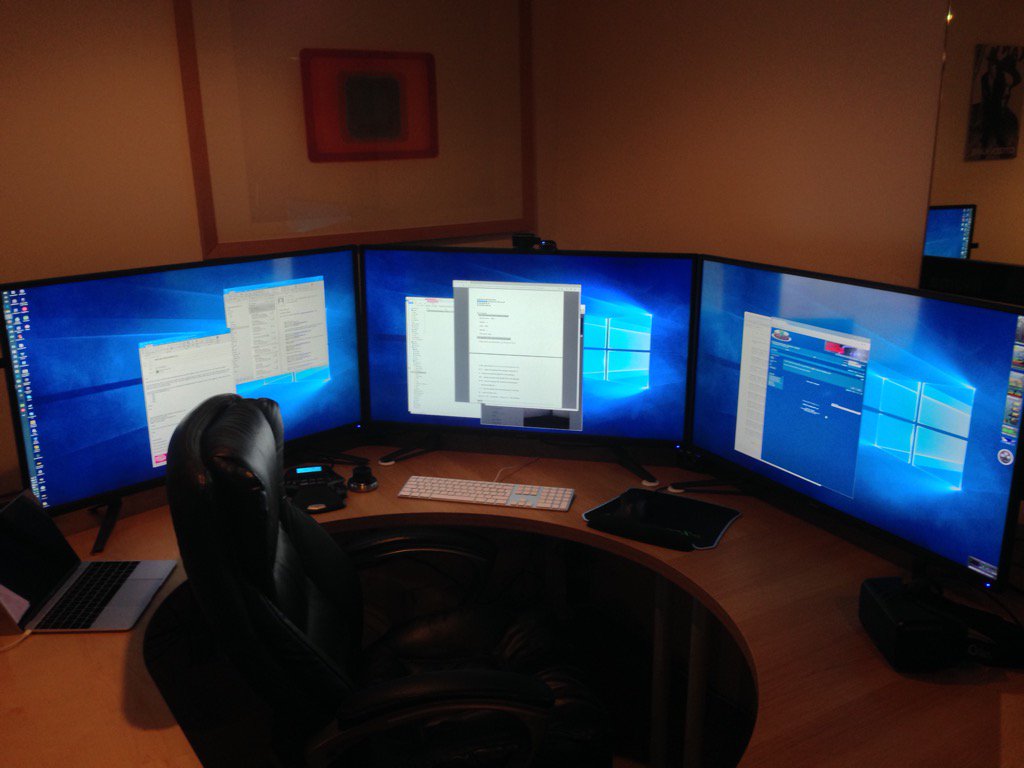

I am liking them considerably more with a round desk and a £2 rubber feet kit from Clas Ohlson:

I can see I'm going to have to spring for stands eventually. I'm wondering if a TV pedestal will do?
EDIT: That pedestal will NOT do. Three of them have just arrived and the glass base is 55x28cm! Takes up far too much space on the desk.
