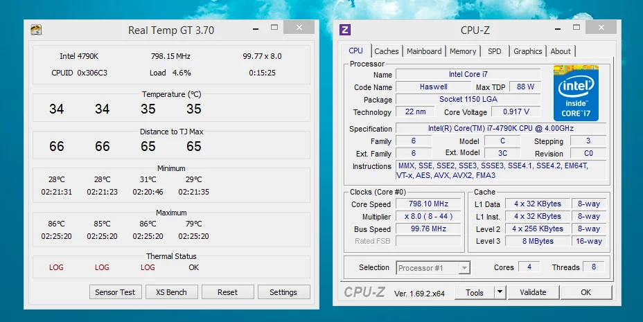

Ok so ran wPrime @ standard settings, got these results, seems high heat as standard?

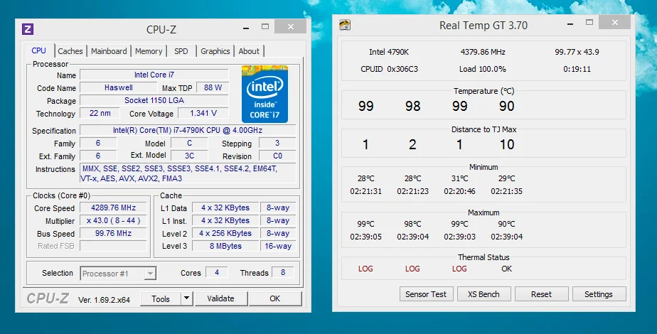

Clicked the auto overclock option in the bios to take it to 4.7ghz and the temps hit 99/100 on all cores. Seems a crazy hot chip compared to my 3770k?
When you did the auto clock to 4.7 what core voltage were you running ?
Try it again with a manually set 1.3v
It had auto set to like 1.42 iirc. Guessing they over volt using the auto setting?
Will try again tomorrow. So set to overboost to 4.7 using the auto overclock setting but also manually set the volts to 1.3?

I would say you are ~0.2v higher than is required. Idle should be ~0.720v so logically speaking if your board is giving you a starting point of 0.2v higher than required for idle, it would stand to reason it would possibly be doing that all the way up to 100% load. I would imagine you should be able to run at stock on 1.2v give or take +/- 0.025v either way.

Idle:
Load:
I know the stock fan sucks, but come on... :eek: :p
latest bios will help with stock voltages
Just updated from F4 to F6 and it is indeed better! Cheers! :cool:
It's still hitting a fairly toasty 80/85c with Cinebench running, but on the stock cooler (with everything auto) I guess that isn't too bad. That's at 4.4Ghz when on auto, too.

I checked with the bios team and all current bioses on the website for Z97 series should have the default vcore sorted out now
