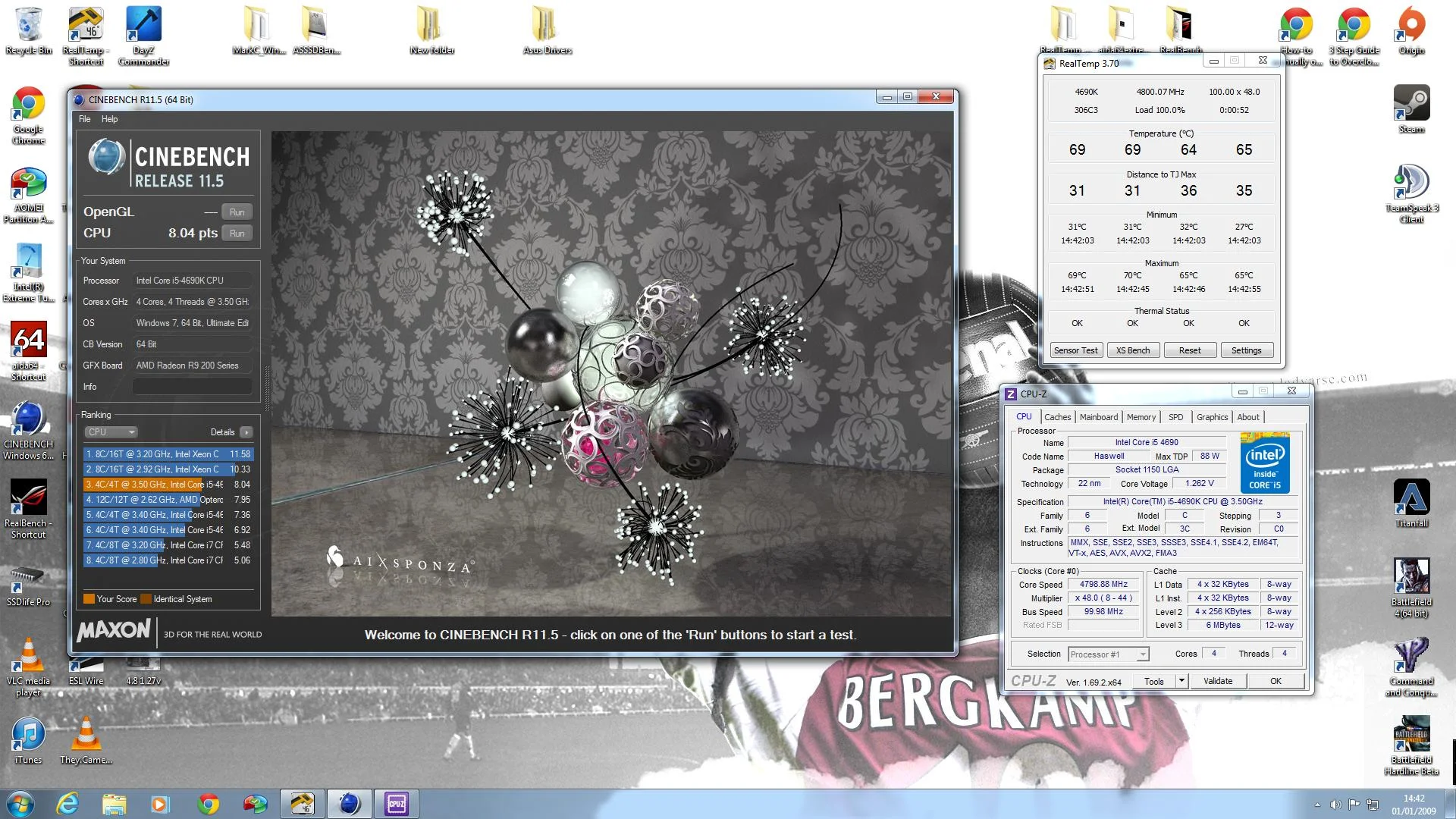

4.8 @ 1.26 volts cinebench with a Noctua D14 in a Prodigy ITX.
