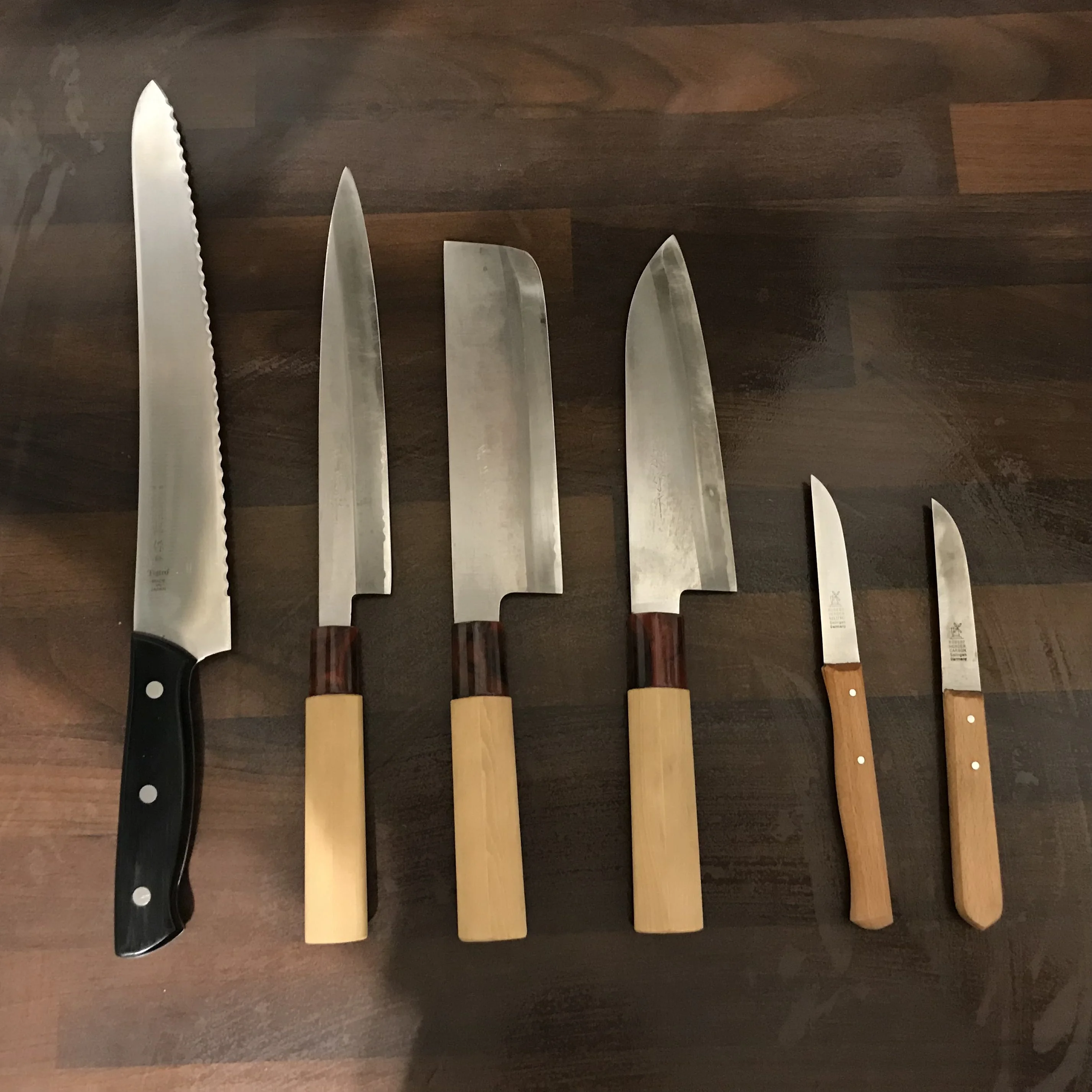

Shaping/paring knife recommendation
one of my most used knifes for preparing vegetables (not peeling, but taking middle out of apple, cutting tomato)
is below, the sharp point and fine blade is useful (is a Gonon Grironde knofe)
Any recommendations for a new one (rivets degrading) was considering Victorinox - Shaping Knife Curved
