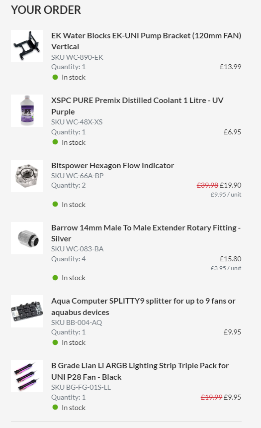

OK. So more stuff ordered. I got two more flow meters to make 4. The straight rotaries are for connecting them together. However, I am going to remove the blades and just use them as a pretty water fall lol. I couldn't get any decent clear coolant, so I went with purple. I won't change the colour scheme as I find it very calming.
I also found a nice RGB plate kit for the unifan I have. At a tenner it was a no brainer. Will possibly mod the other two and put them somewhere in the rig. All the RGB.
Oh yeah. I got a bit lazy and bought the EK mount. I will, however, make some cover plates for it so it looks less anus. Oh and a extremely cheap Splitty 9. I don't like the Lian Li fan hubs they are flimsy and nasty. In fact, I don't even think they are Lian Li I think I found them in a drawer. That will hook directly into the LT.
