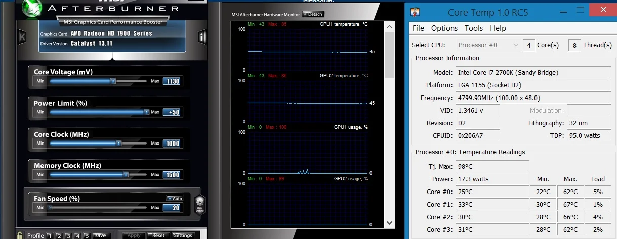

7990@100/1500
Couple of hours of BF4, vsync off, 1440p Ultra preset +x4AA. Fpsd ranging from 60-130+ Using my custom bios. Stock voltage lowered from 1.2v to 1.130v. Case fans on low rpm, H100i on intake on low rpm. 85c max temp on both gpu's. If i turned my case fans up a bit temps would be 3-5c lower. If i turned the gpu fan up temps would be 10-15c lower but im trying to make things as quiet as possible now, just as a personal test. My previous 7950's had to be at 100% fan speed to get even close to this level of performance. For the record Auto fan is around 40-50% at these temps. It starts to crank up a bit once you go past 85-90c.

[email protected]
7990@100/1500

Your bios certainly keeps it cool and quiet, which is also what i am going for.
