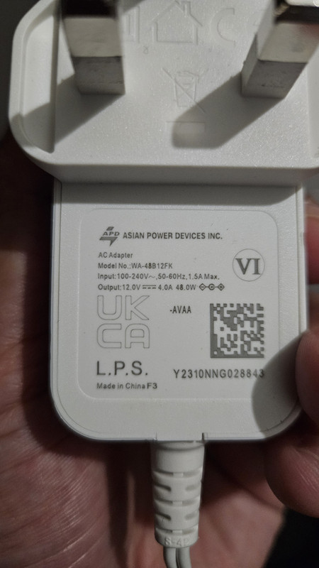

This any good? From Zyxcel 5103E. Or can you recommend one please?500ma garbage
I would say thats breaking down under load, infact I wouldn't use that till you find a proper 12V supply of at least 1.5A
Will do after work, thanks.They look both positive middle pin and thats a 4Amp DC supply. show me the plugs on both!
The Router End
No worries, you must have old 12V power supply from old routers, that 4A is over-kill but should do the job. But 12V DC 2A or 24V DC 1.2A middle pin positive will suite best.Will do after work, thanks.
I did mean the plug on the other end of the cables.
Sorry what's this supposed to do exactly?Could be to fit a 2.5 dia pin with yours being 2.1
They eliminated that problem with a dual type socket https://cpc.farnell.com/cliff-elect...al-2-1-2-5mm-solder-dc10l/dp/CN16318?st=dc10l
Yeah sorry I was hypothesising if you plug the white power supply in and the pin was wobbly, the socket from the link above would solve that problem for 80pSorry what's this supposed to do exactly?
