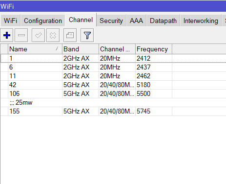

Yeah you will have to get used to using a Frequency instead of a channel, add them manually with this channel guide https://en.wikipedia.org/wiki/List_of_WLAN_channels
So for 2.4G use the following etc...
Channel 1 2412
Channel 6 2437
Channel 11 2462
5G Starting Frequency
Channel 36 5180
And so on...
I build a channel list and choose from that as shown here, don't forget to Null everything out and choose channel at the top, same for security etc. hope that helps a little
But you can achieve the same thing in various ways :D
Glad It's all working anyway!
