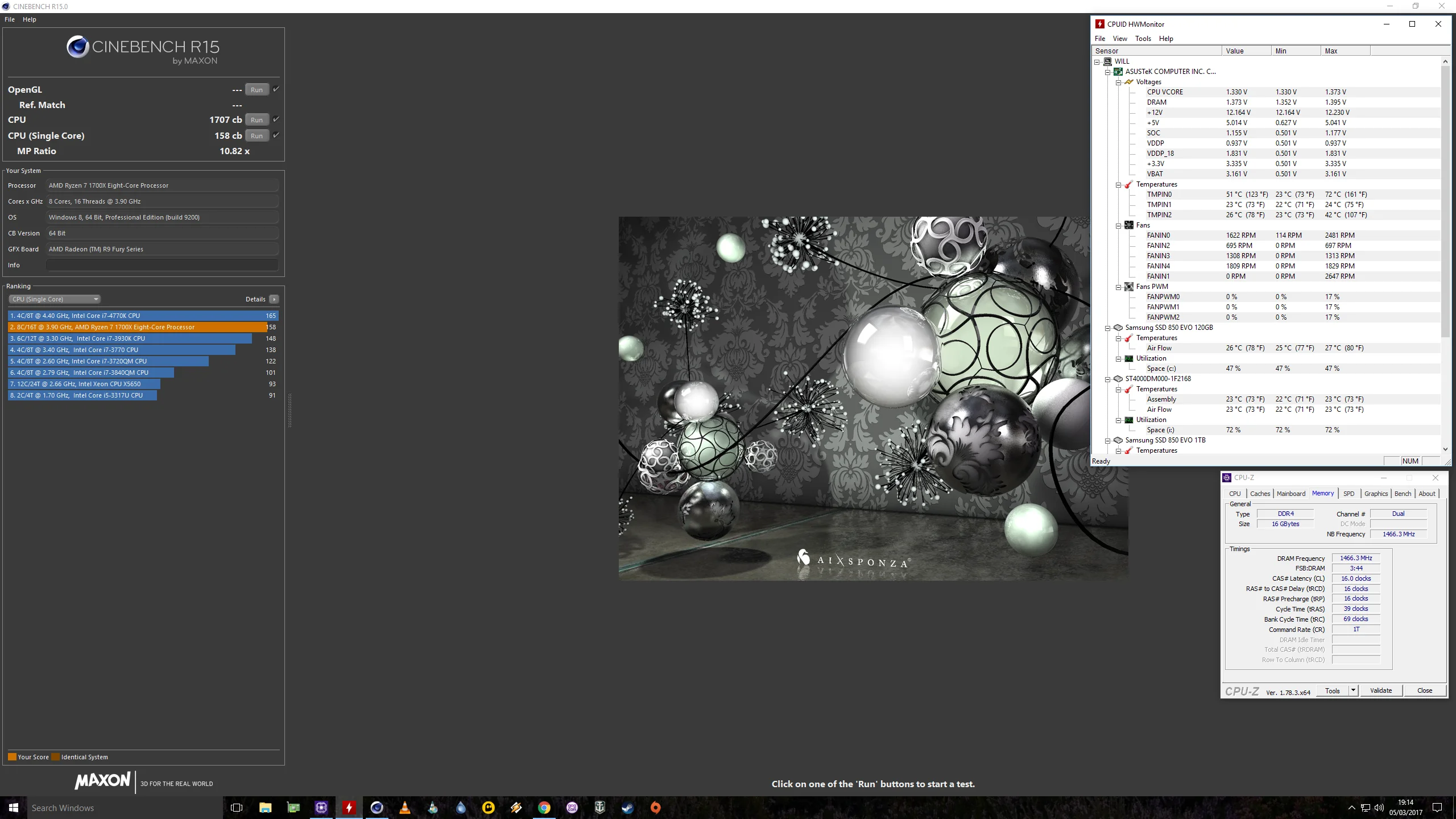

3.9Ghz and 2932mhz on the RAM so far with BIOS 5803 - Broke 1700 on cinebench.
Nice result
Crosshair has BCLK adjustment, you should see better results dropping the memory ratio and cpu multi and increasing BCLK
