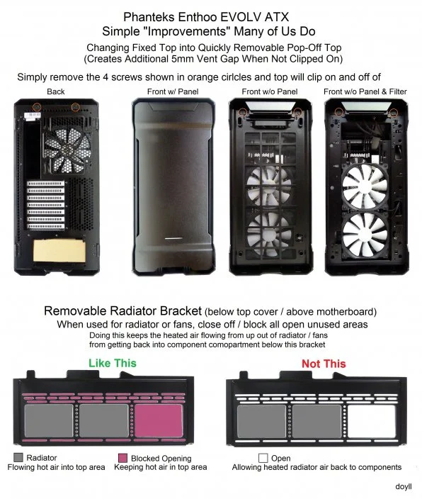

Has anyone tried this?
If you've got 2x140mm fans in the top then you've got a section of the top cavity that will leak warm air back into the case.
Going to give it a try with electrical tape first and if it improves temps I'll get something made out of acrylic

I've not altered the top panel, but I have sealed all the holes in the rad bracket using electrical tape and black card. I've also added rubber washers behind the mounting bars on the front panel to increase how far it stands off, allowing for greater air intake See here. This dropped temps for me by around 8 degrees.
Good to know, I'll seal up the bracket and see how it goes :)

Has anyone else notice who is running a rad at the top of the case how toast it gets, as ive been looking in to methods other than making holes in the top of the the case or does anyone have any tips?
had same problem with my Luxe, in the end just took the top panel off. Temps are 5c better with it off. Looks crap but no one sees it lol
First port of call seems to be blanking off any gaps up top that can recirculate hot air into main compartment, which is a job i have planned for tomorrow.
I've noticed a couple of degree ride in temps in comparison to my old case under both load and idle, nothing to cause concern but i'd like to optimise temps as much as possible.
Ahh cool, ill give that ago today and see how I get one with it. :D
Blanking off gaps helps, as air cannot escape back down in to case then, but the restrictive openings, especially with the mesh, means there is always going to be some hot boxing in the top. Removing the mesh can help slightly also, but if you have fans on intake that's not really what you want as you'll just be bringing in dust. Cutting the top panel is really the best approach, albeit drastic, but Phanteks did not design this case with great airflow in mind, particularly for those of us watercooling. If I watercool my GPU that's what I will do, although not sure on best method yet. A circular saw drill bit is probably the way to go, file down and add some mesh.
I've just made the changes, so ill test it now.
If it works ill get some plastic made up so its a lot more elegant than using some electrical tape. :D
It seems in general use the temps have dropped around 4/5c and there is noticeably more airflow from the top vents.
