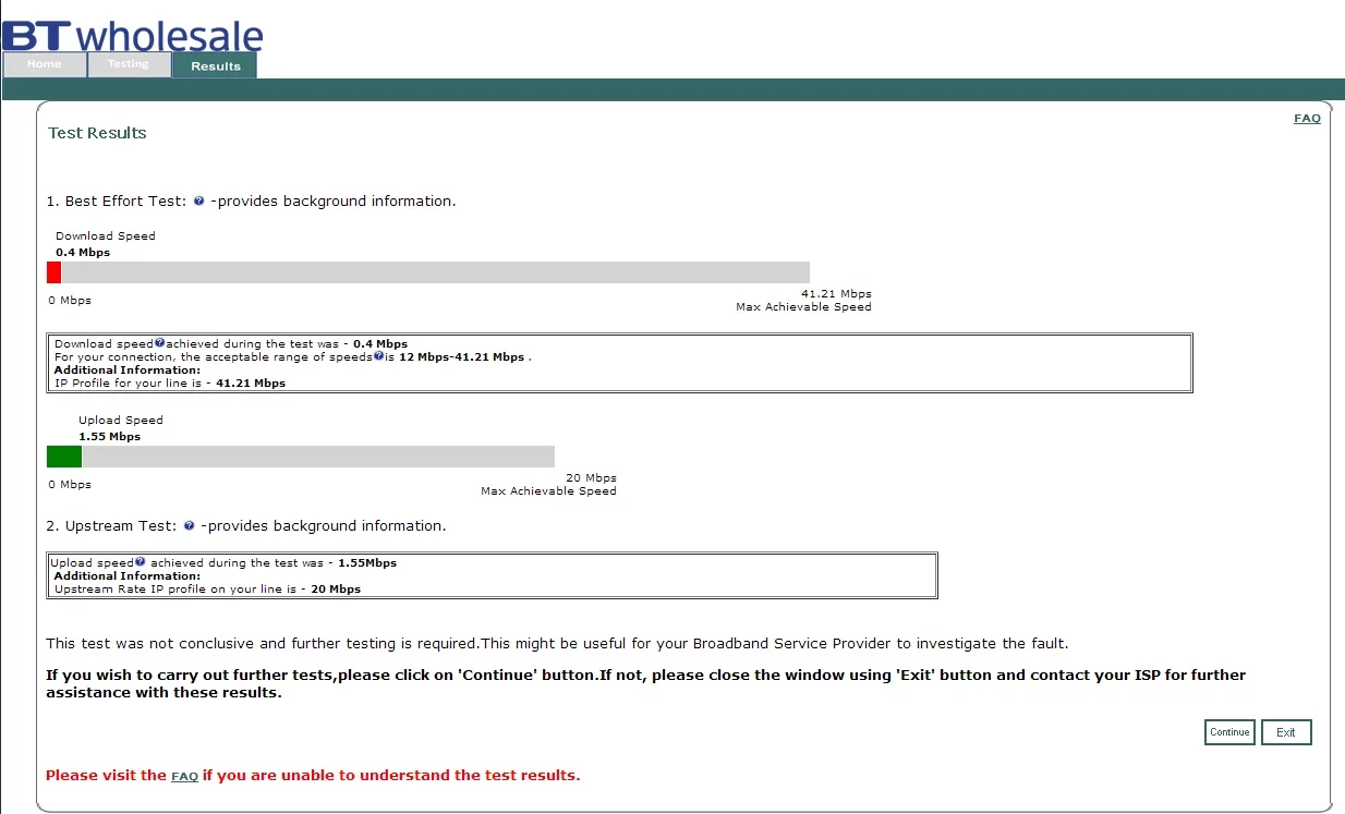

So, your stuck at 0.22Mbps until Monday. That's pretty bad. I think I start to worry about my FTTC with Plusnet expecially the fault will not taken until after 72 hours. I might look at other isp who can fix the fault within 24 hours (not 72 hours)

Yep it a fault as I can understand that Plusnet can reset DLM for ADSL2+ but cannot do for FTTC as it need an engineer at the cabinet (line card) to reset it.
I recently had mine reset, the engineer did it while still at my house just by using his phone to request the rest.

How long did it take from you booking the fault till Openreach did the rest?
Once PN answered my ticket, which took several days, they booked an engineer for the next day. I had 2 visits in total and the reset was done on the second visit. I did get called by PN afterwards to check everything was ok.

Is there any chance that my router (RT-N56U) may be the cause of my issue?
I've wanted to swap it out with the RT-N66U for a while. Every cloud...
I doubt it. I have the same router as you. I even tried the supplied plus net one when I had my issue, made no difference as the DLM thought there was a problem on my line so put me on a lower profile.
