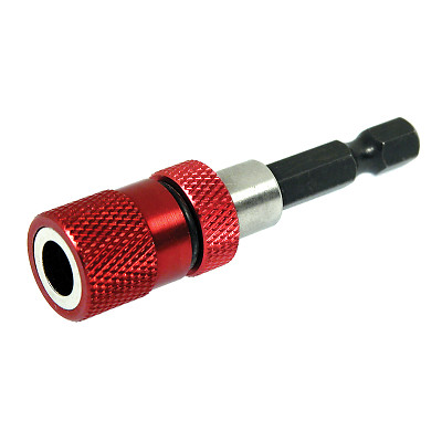

I've seen builders on YouTube using this but I have no idea what it is.
It's like a stop collar for your impact driver bits, so that you can't overscrew.
Anyone know what this is and have a link?
Is this what you mean::

Maybe. Does the screw head sit almost within the unit itself?
Isn’t overscrew down to your toque settings. Any powerful driver or drill will put that bit into the material you are screwing.I've seen builders on YouTube using this but I have no idea what it is.

The idea is that you don't need to hold the screw with your right hand when you are starting it off. Especially with modern screws that are self-drilling, this can hurt/damage your fingers.I've seen builders on YouTube using this but I have no idea what it is.
The holder has a magnet to hold the screw. But you probably know that if you rely on just a magnet, the screw has a habit of starting to wobble and flying off when you are trying to start it off. To stop that wobble, the bit holder has a sleeve that you manually slide out to cover the screw. As it's screwed in, the barrel is pushed back by the holder being driver forward, ready for the next screw.
Because you can't see the screw head, it's best used with a clutch.
