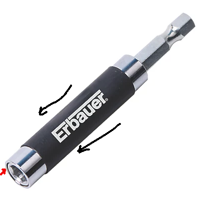

Something like this (expensive Wera version)…
Do you have a link for this thing, or is it what was posted above?
If not I'll try to find a screenshot of it. I've seen quite a few YouTube channels use them including properdiy.
What is posted above.
If you look at the pic, you can see there is an outer sleeve (red arrow). The sleeve slides forwards (black arrows) to stop the screw wobbling.

Looks like a socket set nut driver TBH.
Yeah but it's not as he is screwing in featheredge.
Ok, just looks like a standard bit holder at first glance.
