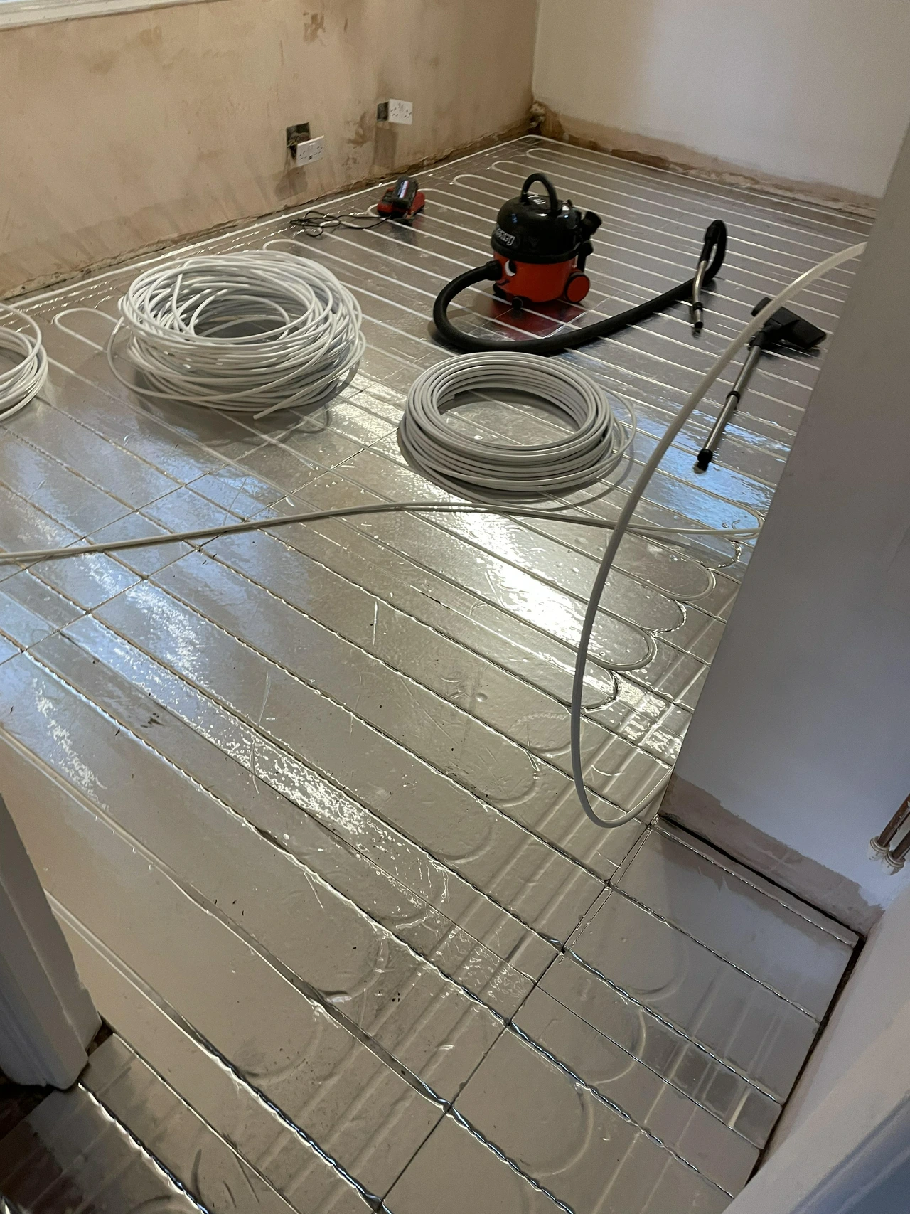

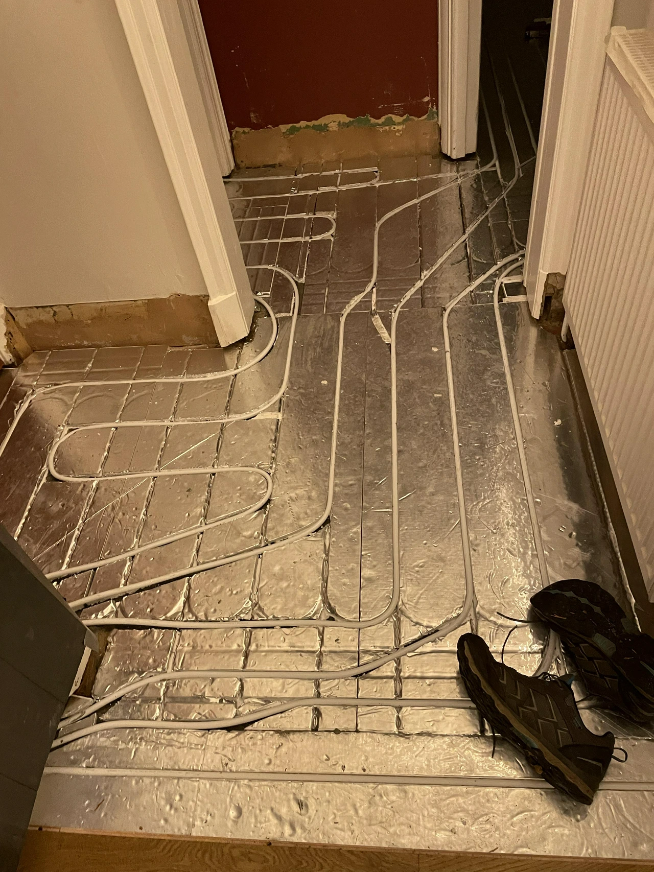

This was mine in the process of being installed (retro-fit on hard floors) using these insulation boards, which are 16mm, exactly as you say.
insulation boards laid in room with pipes to go in:
Some pipes in awkward hallway, next to manifold. Lots of pipes going from here to various rooms:
