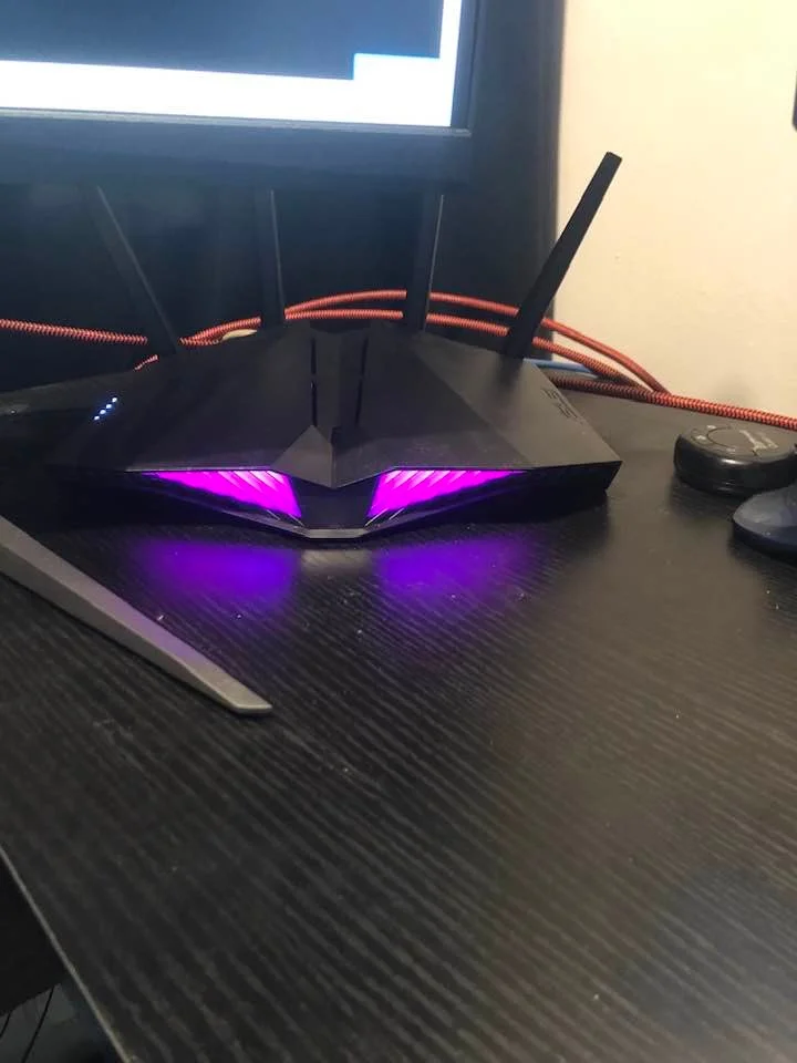

I've got a Quest 2 and also a WiFi6 AX200 160MHz built into my X570 Tomahawk motherboard but it just didn't work very well, even with Virtual Desktop. Win10 seemed to throttle it (connecting my phone first sometimes helped unlocked the faster link speeds but not always) and the constant WiFi scanning didn't help, but even running a script to disable that I still didn't get a reliable connection with approx. 500Mbps link speed. But I couldn't go the cable as I'd get tangled up and I also felt that it was putting extra wear on the USB port on the headset.
I ended up getting an ASUS TUF-AX5400 which is connected directly to my computer's ethernet port with CAT6 and it's also connected to my LAN via the wall RJ45 with another CAT6 to get the internet side of things. Setup the 5GHz channel accordingly and boom, a constant 1200Mbps link speed and constant Network reading of 5ms. It even maintains full performance through a single skin brick wall. Love it!
That's the problem with using a built in Wifi adapter or PCIe/USB network adapter. It might work but, more often than not, it won't. And even if it did work, in most cases, a dedicated router would still be better. Windows doesn't handle that kind of networking very well.

I have the Asus AX5400 wifi 6 router...Its been great, Loving it :)
