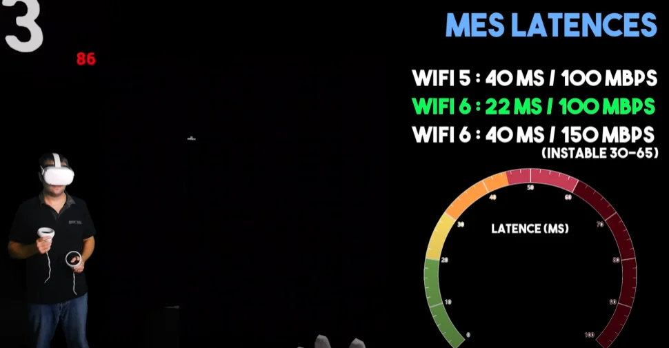

I don't have any switches or AP's to test, in theory it shouldn't make a big difference but you are only going to know by testing both ways.
Iirc, tyriel said the best connection he managed using any method was 22ms, which was the same for wifi5 or wifi6, so if you connect and see something like 30 or 40ms then you know you have room for improvement

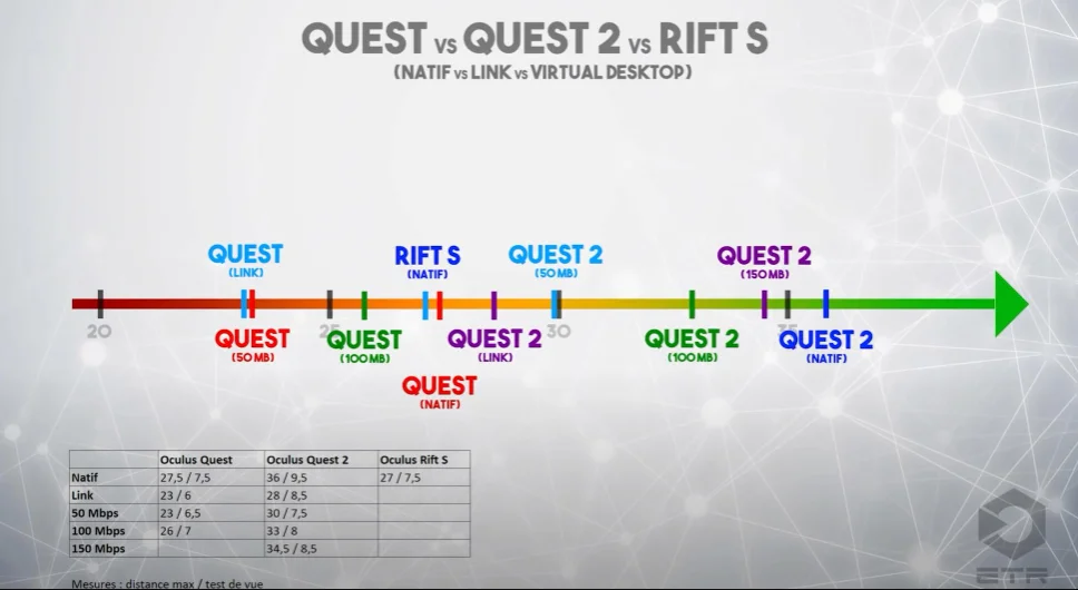

Found a good video testing latency on the Quest 2 using the Link and Virtual Desktop on Wifi 6 and standard 5Ghz.
https://www.youtube.com/watch?v=6i928zhM7SA&feature=emb_title
It's in French so requires the auto-translate captions.
