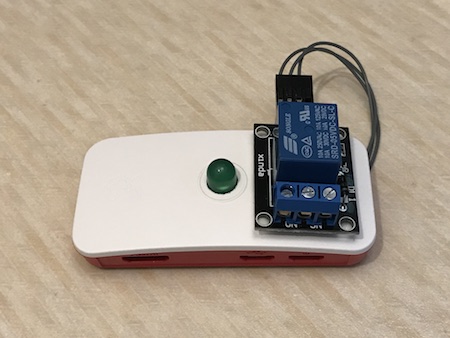

Well it's done, Pi Zero W with a relay.
The power to the router goes through the relay, I just broke into the power cable.
It boots and checks the internet connection every ten seconds, if all is good, the green LED flashes briefly. If it fails to get a response within two minutes, it triggers the relay for ten seconds which drops power to the router. It then sleeps for four minutes to allow the router to restart and reconnect to the internet and then starts checking again.
The relay isn't energised normally, the connection the router goes through is normally closed so I can restart the Pi without causing the router to drop out.
I'm very happy with this. This is the first time I've done anything with the GPIO and although I found some simple Python code to check the internet, I've tweaked the whole thing to work as I want, including the LED flash each time the check is successful.
I did have a problem where the relay would trigger on reboot and it took me a while to work out what was actually happening. The Pi was booting and starting my Python routine before the WiFi had a chance to connect and so it was seeing what it thought was an internet drop and going into the reboot routine. A simple sleep command in the appropriate crontab entry to just wait fifteen seconds before starting was a nice straightforward fix.
In my mind, this is what the Pi is all about, thinking of something it can do and then finding a way to do it. This only occurred to me on Wednesday afternoon and now, three days later, I've done it!
I like that, I like that a lot.
My router occasionally throws it's toys out of the pram and won't reconnect, some times it's the wireless network that falls over (two teenage boys, poor wireless gets hammered) other times it's the wan connection. Would you be kind enough to post your code up for a look see? I'm thinking about building it into the pi I already use for pivpn and pihole (still working flawlessly too :) ), that's connected to the wired network but I could add a wireless dongle and then ping over wired and wireless to keep an eye on both....

No problem. I found the base code online and tweaked it a bit. I know it's really simple stuff but it's the first time I've done anything with Python so I'm quite proud of what I've done.
check.py
Code:
import urllib2
import RPi.GPIO as GPIO
import time
RELAY = 21 #RELAY PIN, physical pin 40
ALIVE = 20 #LED PIN to flash LED on live internet, physical pin 38
CHECK_EVERY = 10 #Seconds
GPIO.setmode(GPIO.BCM)
GPIO.setup(RELAY, GPIO.OUT)
GPIO.setup(ALIVE, GPIO.OUT)
# Force both outputs low
GPIO.output(RELAY, GPIO.LOW)
GPIO.output(ALIVE, GPIO.LOW)
def flash_ok():
    GPIO.output(ALIVE, GPIO.HIGH)
        time.sleep(0.2)
def internet_on():
    try:
        response=urllib2.urlopen('https://www.google.de', timeout=240)
        print "Internet OK"
          flash_ok()
        return True
    except urllib2.URLError as err: pass
    print "Internet ERROR"
    return False
def reboot_router():
    print "Rebooting Router"
    GPIO.output(RELAY, GPIO.HIGH)
    time.sleep(10) #Energise relay for ten seconds
    time.sleep(240) #Wait for four minutes for router to reboot
while True:
    if not internet_on():
        reboot_router()
    time.sleep(CHECK_EVERY)
GPIO.cleanup()
watchdog.sh
Code:
#!/bin/sh
# watchdog.sh
# Changes into watchdog directory and runs the python script
cd ~/watchdog
sudo python check.py &
In crontab:
Code:
@reboot sleep 30 && sh /home/pi/watchdog/watchdog.sh > /home/pi/watchdog/logs/cronlog 2>&1
The two files sit in ~/watchdog and in there I've also created a logs directory.
The code itself should be fairly self explanatory. Don't forget to chmod +x them both.
I can hear you saying "why is he using google.de to check?"
Well I run Pi-hole. I don't want the URL I'm checking to be in the Top Domains list on the admin page so I simply picked a site which should always be there and added it to the Pi-hole settings so that it won't appear on the list. You could choose anything really.
