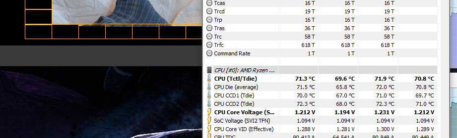

1Usmus / Auto voltage
5 runs of CB20 - This is the highest voltage i saw; 1.231v spike / Average 1.212v
