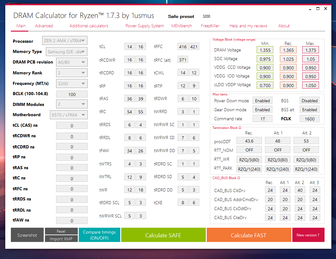

Some of that looks a bit beyond my understanding (probably an understatement), but after checking out the first link I printed out my DRAM calculator settings, and then entered the BIOS to alter as many settings as I could find/was comfortable altering.
* tCL = CAS latency, right?
* tRFC (alt) I used the option tRFC (2)
* I struggled to locate the VDDP voltage and although the caluclator recommends 0.900, the most available appears to be 0.700.
* I couldn't locate the VDDG voltage at all.
* The DRAM voltage recommendation is 1.375 though the options are slightly different: 1.360 / 1.370 / 1.380, for example.
I saved and exited and booted up without issue (so far).

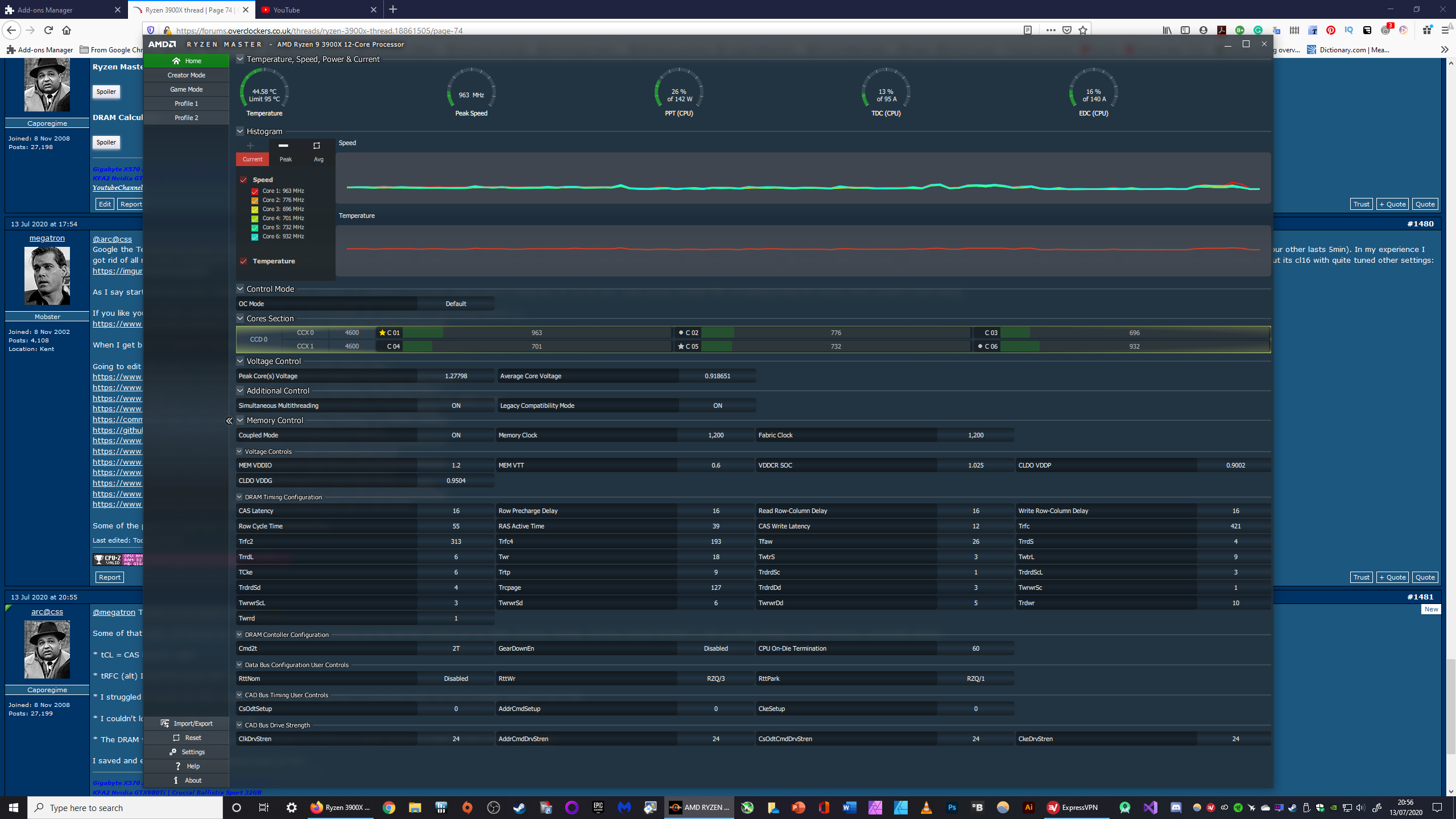

My main Ryzen Master settings after that bit of tweaking now reads:
The first thing I've noticed after having just accessed a few sites, e.g. OcUK, is just how snappy it is in comparison to what it was before.
@arc@css

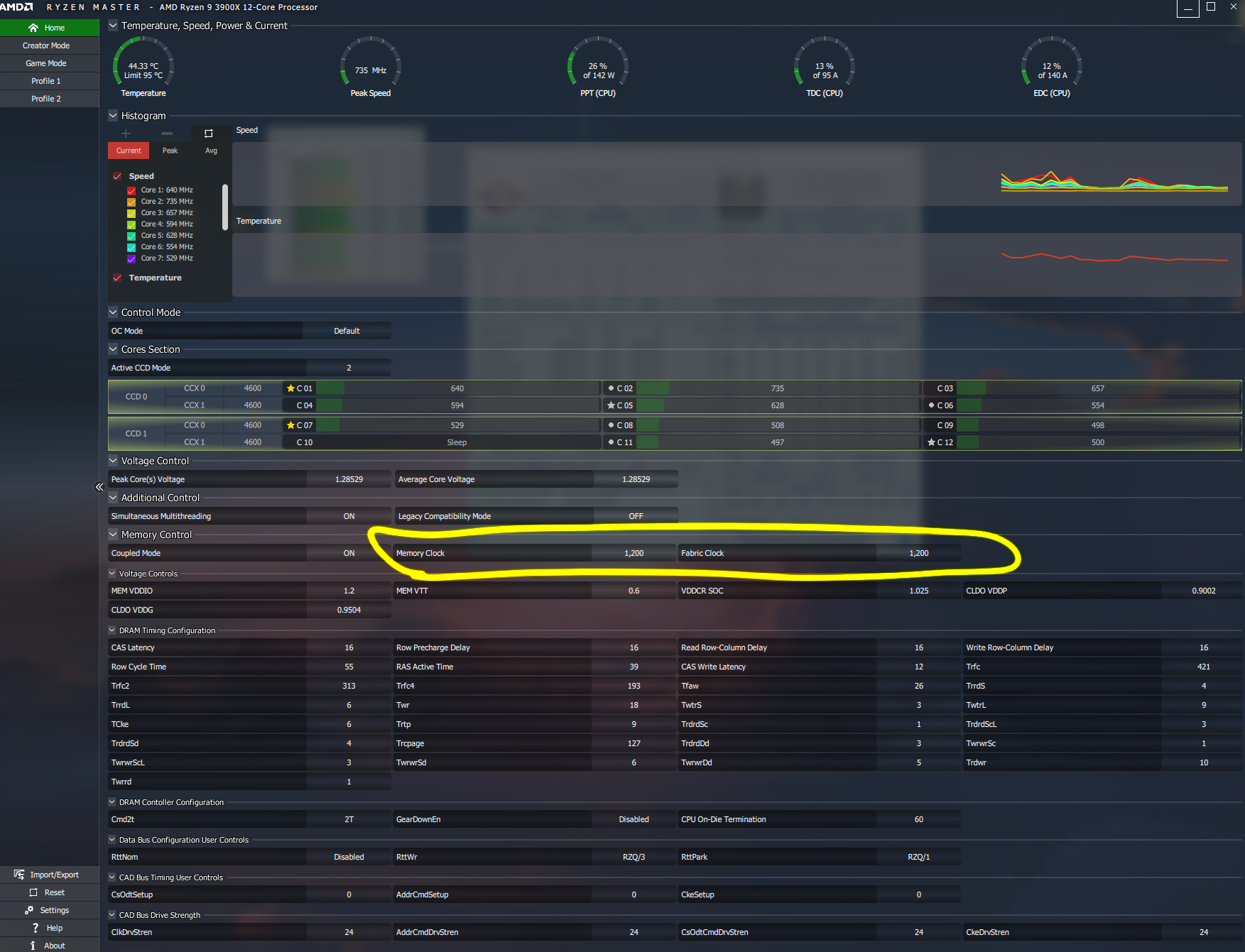

You have made a mistake somewhere because originally your Memory and IF were both running at 3600 now they are both only running at 2400.
You need to go and put them back to 3600 for better performance.

I've then run the DRAM calculator again but this time elected to go with safe settings. The program appears to have been updated since I last used it and some of the readings were absent this time:
In a mo, I'll try applying the safe settings.

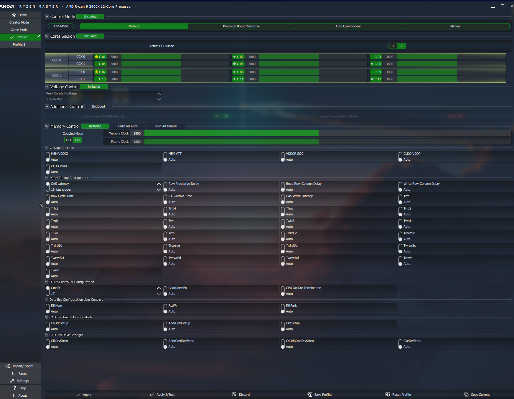

I didn't realize you could apply some of the BIOS settings via Ryzen Master, so after having little to no luck with the above, I simply set the memory & fabric clock to be 1800, with the tCL set to 16, and the command rate to 1T. Everything else has been left on auto for the mo.
I've uninstalled the Gigabyte app centre software - which seems to be what I often read that people do (may have been as much of a hindrance as a help?).

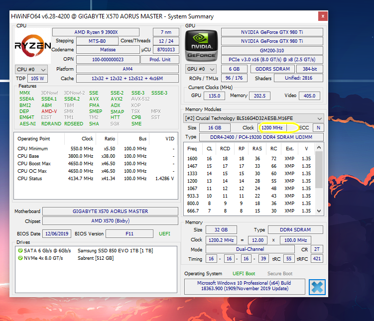

Tried applying the memory/fabric clock in Ryzen Master but despite applying it in the profile section, it still reads as 1200 (same also for HWinfo).
I'll try doing it in the BIOS.
Seems to have worked. I selected the XMP profile in the BIOS for now.
Why are you using Samsung settings when you have Crucial memory? Your sticks use Micron E die according to the part number in your cpuid screenshot. You can check your chips using Thaiphoon Burner if you want to be sure, but Micron chips definitely wont work with Samsung timings. Sorry if this has been covered before, I read back a page or two and didn't see anything :).
[EDIT - That's actually a 3200mhz part number, as you have 3600mhz XMP I assume its misreading the part number somehow?]
Thanks for that, it hadn't occurred to me. :)
So, I guess I'd better head over to the crucial memory thread.
