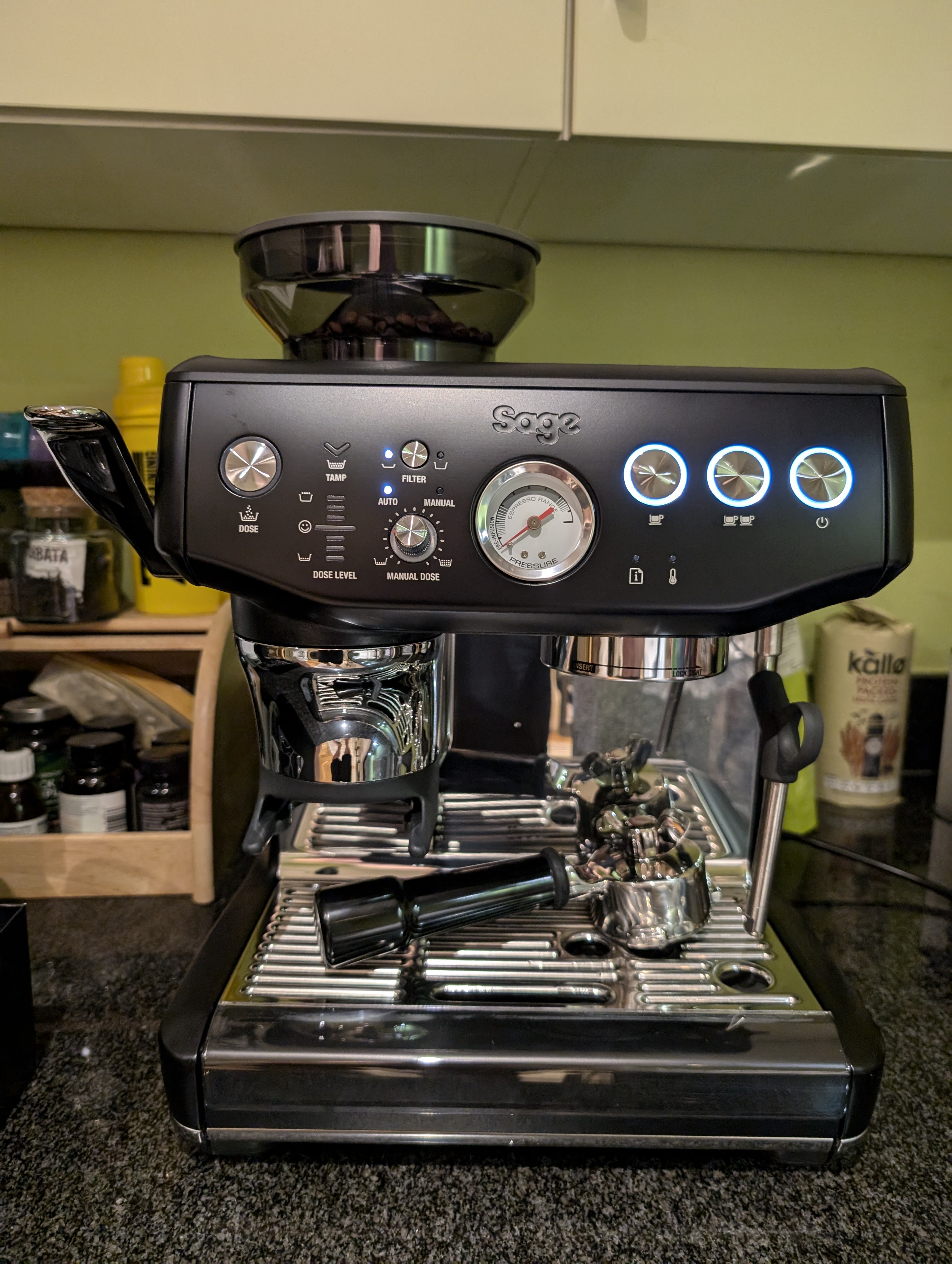

Anyone had any joy stripping down a barista express? Mine has a terrible leak and although this unit is a warranty replacement, Sage aren't interested in honouring a years warranty on it. If I can't fix it I'm really tempted by the Lelit units...

Some tear down photos would be great thanks, I've had the back off but quickly came to a stop as it looked almost impossible to take it any further.
