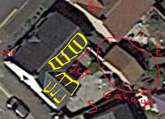

This is what I cannot understand. I cannot see the point of having panels in North facing roofs.
There are couple of more bits of unshaded roof, one SE and the other SW that I am sure can accommodate 7 more panels. The main SE roof I am sure can take more than 9. That was my initial thinking.
I ve actually spoke with the guys, no mistake, they are adamant this is the best solution. Easy 14K

Very grateful for your responses, I tried to insert a photo of my rather complex roof but cannot make it work.

Well, I never really focused on the North roofs as I thought they were out of the question for panels. I think the NE roof in the main house has a bit of sun early in the day but very quickly goes in the shade, the roof angle is about 45 degrees. The garage roof again has a reasonably steep angle so pretty much always is in the shade. I doubt they will produce enough energy to justify the cost and hassle. Do panels produce reasonable energy even if in the shade and only a short time in direct sunlight?
I hope I can get 17-18 panels in the south facing roofs, this would be a 7KWH system which maybe would just about cover house + a bit of electric car charging.
