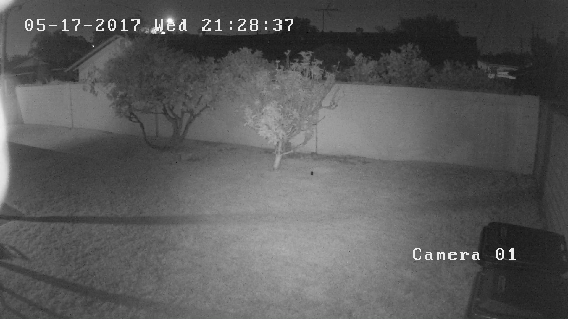

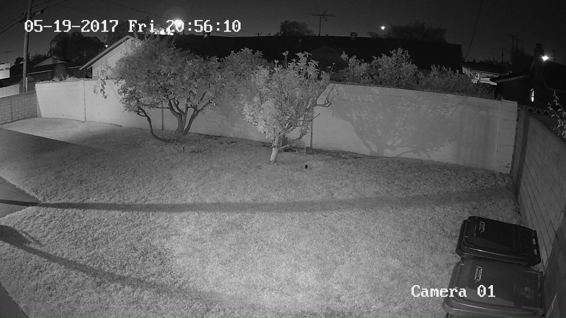

In layman's terms what's the difference between the 2335 and 2342 that you said you didn't like?
The 2342's are rubbish in darkness as they are not meant for low level light.
The 2335's are low level light and are classed in a similar group as the dark fighters.
The 2342 are slightly better and sharper than the 2335 during daylight but at night the 2335 is superior.
Example from another site. Every location is different so you have to make changes to image settings to get the best.
2342
2335

Thanks for those! That is a fair difference but is it enough when considering the drop in daytime performance? To help decide is there any chance you could please post a daytime comparison from the same positions? Or do you not have one?

I don't have any of the two at the same location. If I had time I would rig two up for testing but I am away to NY tomorrow.
You need to decide if you require daytime viewing more than nighttime. If you want good daylight and not worried about nighttime then opt for the 2385. If you want good nighttime then you need the 2335 as the 2385 will look poor from the reviews I have seen due to its high MP and not being a low level cam. Some say it's worse than the 2342.
In some installations you can stick both cams up at different angles to counter this or stick led floodlighting up and disable the IR. I did this and worked great. So many different things you can do to get the best out of your camera.
Also, the 2335 is a H.265+ cam, doesn't use an external light sensor and is made using newer technology compared to the 2342. Older generation.
