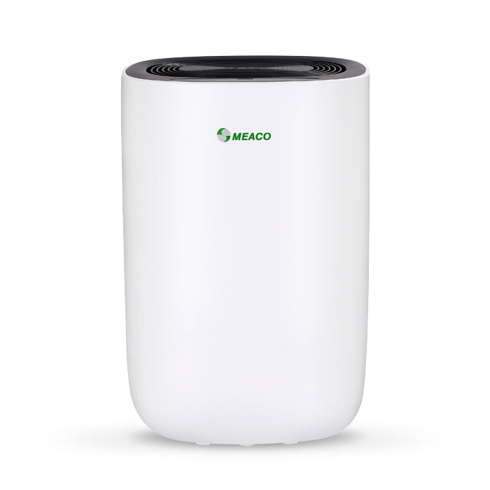

I managed to pick up a 20l Meaco Arete from Argos last week and so far I'm really pleased with it. It's replacing a 20l one I picked up from Aldi a good few years back. The extraction rate of the Meaco seems to be a lot better, whilst drawing just over half the power as the old one :)

Not seen those before I was about ready to get the Ebac 3850e but the 25L Meaco Arete looks good. Need to see is power consumption.

What was your trick to get one cos they are out of stock everywhere?

Complete luck. I was looking for a few weeks prior to getting it and couldn't find stock anywhere. Somehow one came available for delivery to any of my local Argos stores. Home delivery wasn't an option, only branch collection. To be honest I was expecting an open box/returned unit, however it was all still factory sealed and brand new.

If you can wait a little longer, hold out for the Meaco Arete 12 litre. Stock on those models is poor right now but should be coming back early Dec I've heard.
