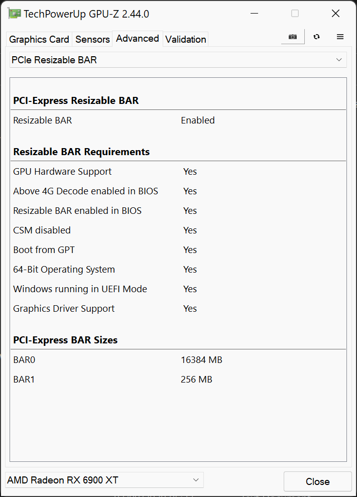

In the performance tab of the AMD software its telling me SAM in not available but its enabled in the bios?
GPU-Z has a tab at the top (Advanced) which should tell you if you fail to meet any of the requirements to support SAM.

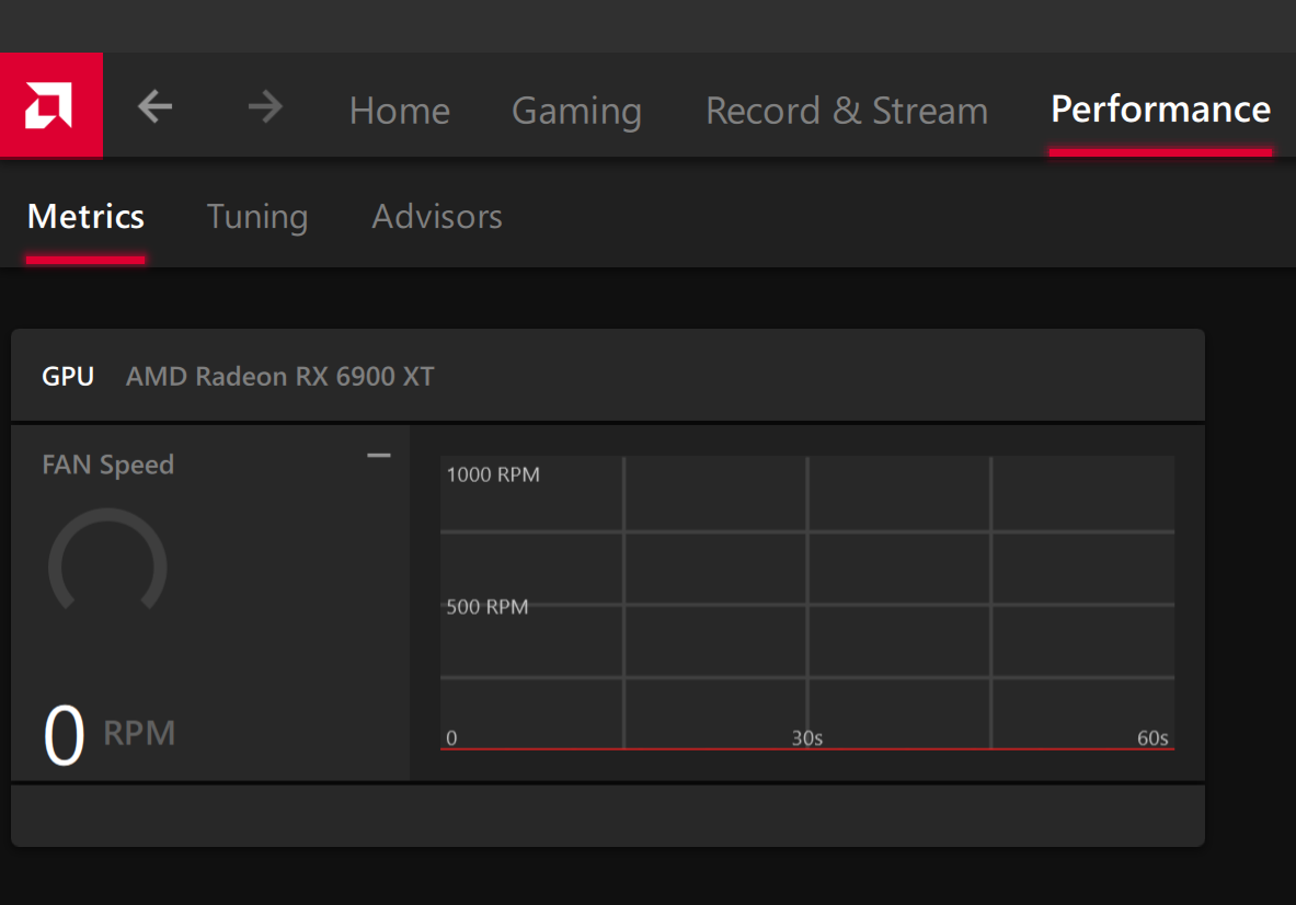

Do you mean this?
Or this?
@LtMatt
Both, though the CPU metrics have returned to normal.

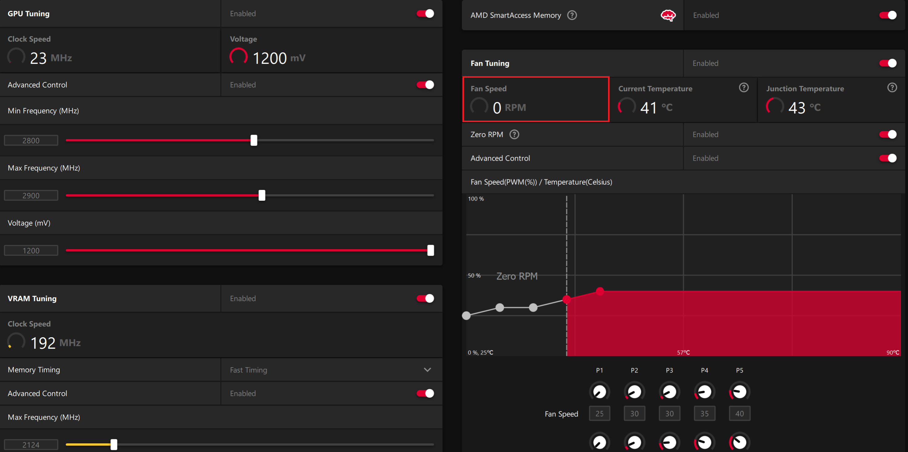

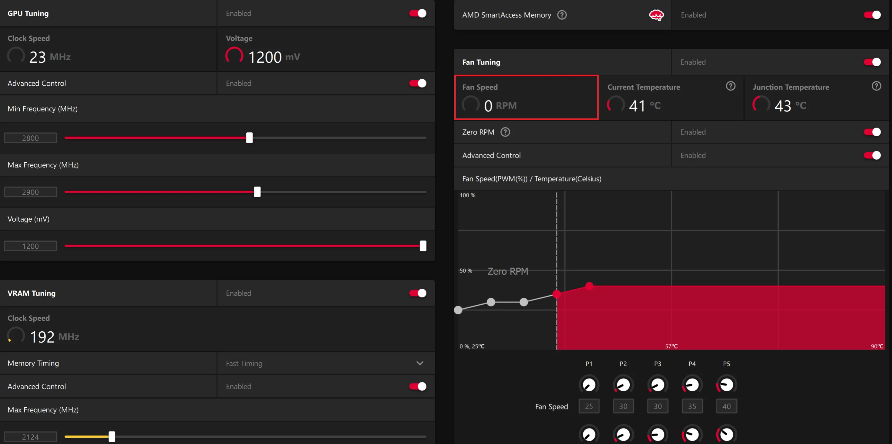

The fan is going mental in Plague Tale at the quit screen, temps not going above 55 though, and I have not messed with the fan curve.
Did it work previously? If so what changed.
You should be able to monitor and adjust fan speed in GPU Tuning.
Are you using a full install, or minimal? Might not be available in the latter.
  • Install Type:
    • Full Install: Provides all Radeon Software features and controls for gaming, recording, streaming, and tweaking your performance on your graphics hardware.
    • Minimal Install: Provides only the basic controls for Radeon Software features and does not include advanced features such as performance tweaking or recording and capturing content.
    • Driver Only: Provides no user interface for Radeon Software features.
Also, have you installed or used any third party software that can control these settings like MSI Afterburner, etc?

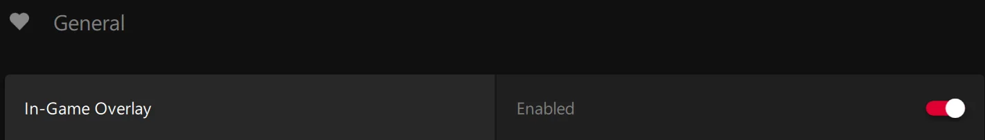

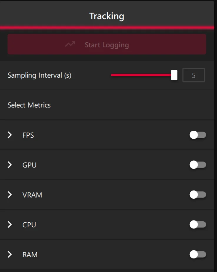

Check that you have the In-Game Overlay enabled (under Preferences) and you have not disabled the metrics (Performance tab > Metrics) which would allow monitoring of fan speeds through the UI and In-Game Overlay.
If the above is all checked off, try a factory reset and a full install.
