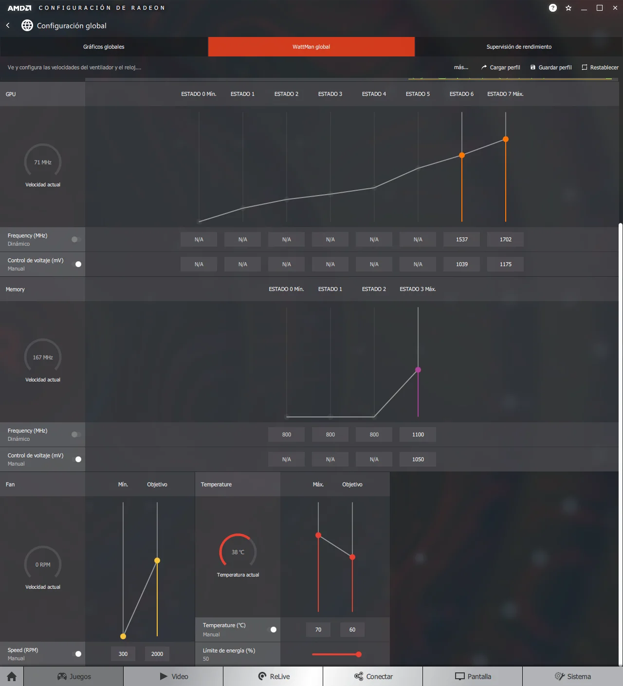

If you show us your Vega 64 settings we can tell you how to improve.
Which Vega 64 you have?
Nitro+
Try to raise the clock to 1712 or lower the power to 1160.
Set the floor power (under the HBM) to 1000.
Let me know how it goes, at is should be around 26100-26200 with reduced power consumption.
The reference on air can do 26063 with
P7 1692 1150mv
P6 1537 1100mv
HBM 1100
Voltage control 1000mv
PL +50%.
Tried:
P7 1707 1170mv
P6 1537 1039mv
HBM 1120
Result:
https://www.3dmark.com/3dm/30087780?
Nice bump :D
