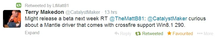

New drivers will be coming out on or before the 25th. You heard it here first.
Thanks for that bit of info. May get the 7990 working with Mantle after all. Then again AMD may have forgotten about it's customers who have older GCN cards.

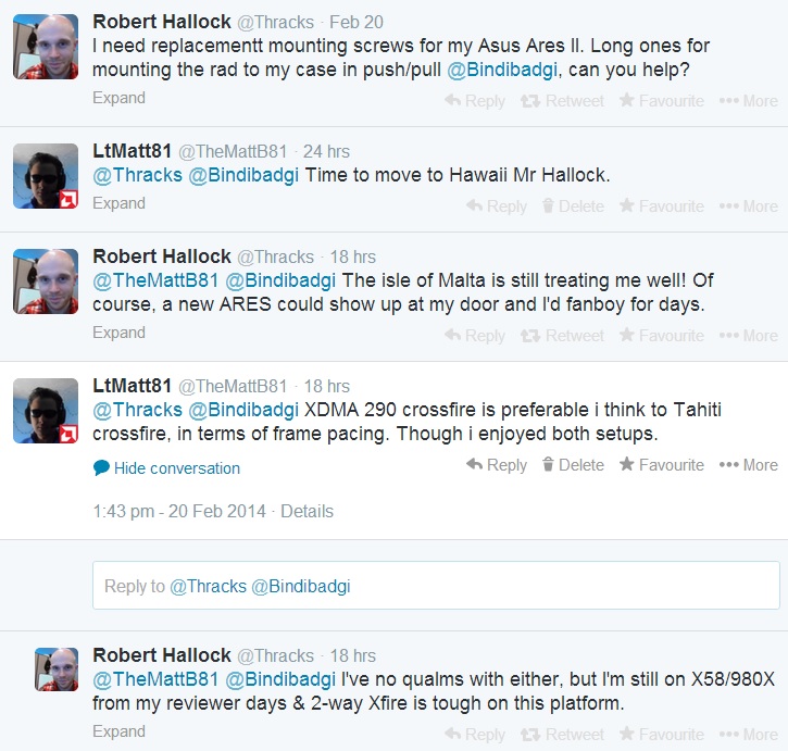

Doubt it very much. Thracks has a 7990 Ares card. ;)
^the screws he needs will either be 6-32, m3 or m4, though iirc most of those aio rads are a 6-32 thread and he'll need them ~30mm long. Him being in the backwards word of north America he should have no problem picking up some imperial threaded bolts :D
Yes i think they're the same ones i use on my H100i. I actually have some spare ones as well, but ill be damned if im shipping them to the US. :p

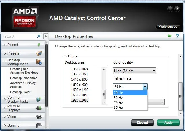

Right - Having a bit of a nightmare here. New 7850 arrived and I did as LtMatt advised above, used DDU to remove the nvidia drivers then had it shut down the PC. Removed 9800GTX and fitted 7850. Started the PC back up and installed CCC and the Radeon drivers. It went through all that fine and then restarted the PC. PC booted to desktop in my monitors native resolution (LG E2242) @ 1920x1080. All fine at this stage. I fired up Arma III and had a go, pleased to see a substantial increase in performance. However, there was some noticeable flickering on the screen, especially in dark/night missions. Anyway, quit the game then went back to desktop. I then installed MSI Afterburner and started that up, however I didn't change anything in there at all. Restarted the PC and it booted to desktop but it was in 1024x768. Tried changing the resolution back to 1920x1080 within CCC but when I do that the refresh rate changes to 29mhz. If I then apply those settings the screen goes black and I get a 'Monitor out of range' message on the screen. I then need to reboot and try again.
I've no idea what I've done wrong but whatever I do I cannot get back to my usual screen resolution even for just Windows, never mind playing a game. I've uninstalled MSI Afterburner but it still does the same. So I uninstalled the ATI CCC/Drivers and restarted then went through the driver install process again. Rebooted and its still the same - 1024x768.
HALP!!!!! :(
HALP!!!!! :(
Did you run DDU12.3 (theres been a new update since we last spoke) in safe mode? Best to login to safe mode, run DDU, clean and restart then install the 13.12 WHQL drivers in express mode. Restart and you should be good to go. Leave afterburner for now and make sure your gpu is working ok first.
Yep, did all that first time around and as I said, initially it worked fine. I've just went through the entire process again and its still not right. Now when the PC boots to desktop the monitor goes blank and I get a message saying 'D-Sub Out of range 75.0kHz / 60Hz'. :confused:
D-Sub? does you monitor not have DVI?
@ Draeger, the GPU is putting out a refresh rate your Monitor can't handle in D-Sub.
Go into CCC and set the refresh rate to 60Hz. Or use the DVI.
Nope, monitor doesn't have DVI as far as I know, I've always used a VGA-DVI adapter into the back of the GPU. I'll try resetting the refresh rate in CCC now that I've tapped F8 and booted into 'low resolution mode' but I think it will still do the same thing. Cannot understand this for the life of me considering it all worked fine initially and even let me play a bit of Arma III.
The GPU (not knowing) may be putting out a DVI signal which is freaking your D-Sub Monitor out.
I don't have a D-Sub adapter so i can't replicate your problem, but i will install CCC and have a look, see if i can find the right settings.
Thanks, appreciate the assistance. I managed to change the resolution in CCC to 1440x900 and the box on the left with refresh rate in it stayed at 60hz. But as soon as I try changing the box on the left with screen resolutions to 1920x1080 the refresh rate box changes to 29hz and I can't change it back to 60hz as you can see:-
