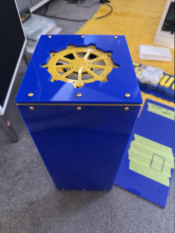

I’ve now marked out where the power connector hole needs to be and the size.
This heat is crippling me. Seriously it makes my arthritis so bad I can barely walk ffs.
OK no pic update.

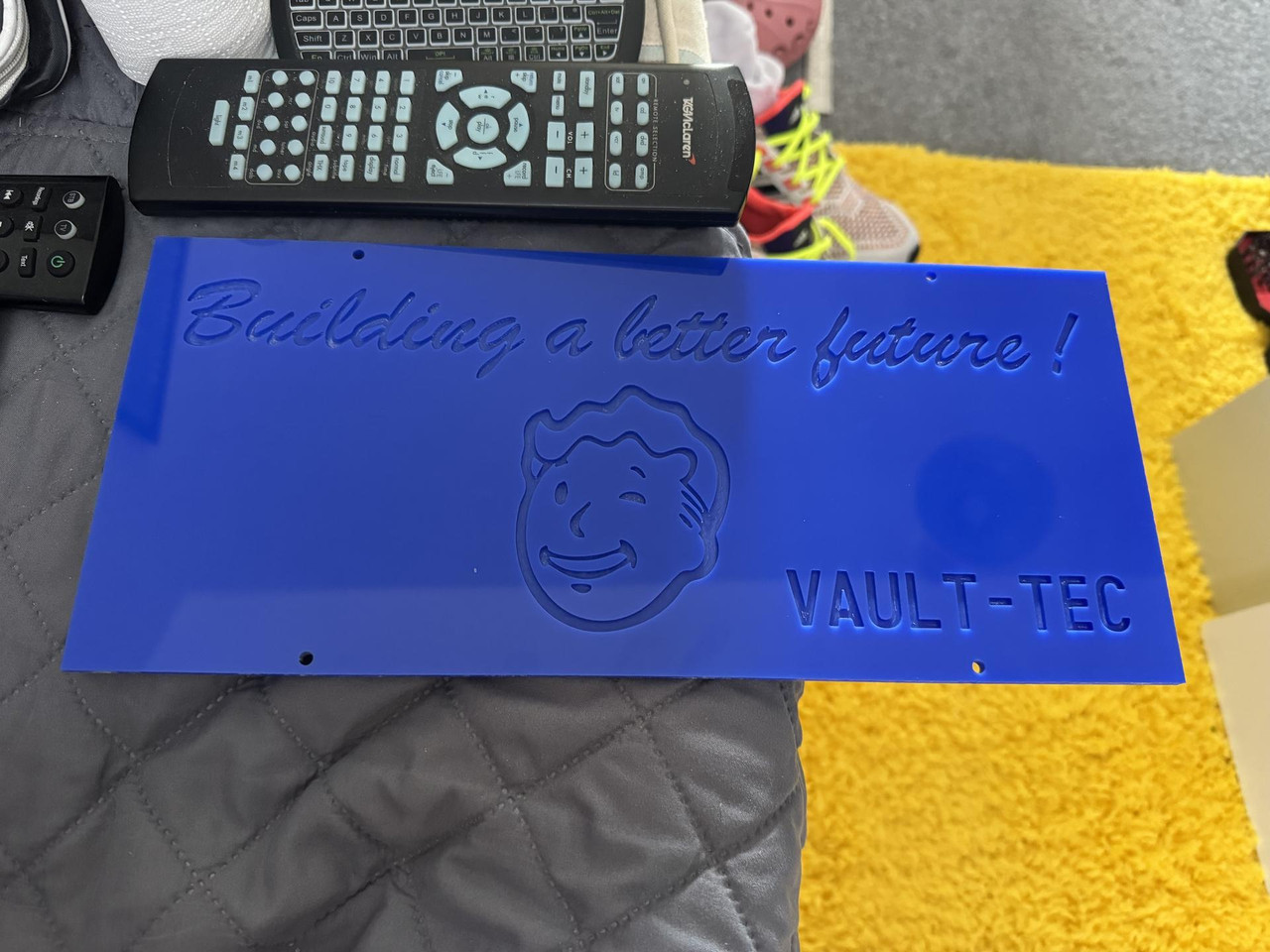

I’ve now drawn out the final panel. Spent two weeks deliberating on it. When I ran a simulation it seems the 1.59mm bit would miss fine detail. The largest bit I can get away with is 1.2mm. Guess what? I didn’t have any lmao. I daren’t use a 0.8 as it would take around 7 hours and besides there’s a high chance it would snap too.
So I ordered some. Noting they have doubled in price since last year.
I also realised being on the PC is too uncomfortable for me due to the infection that I’ve had all summer. So I’m going to use the laptop. But of course no free power sockets so I’ve ordered some doublers coming tomorrow.
OK got a lil something done.

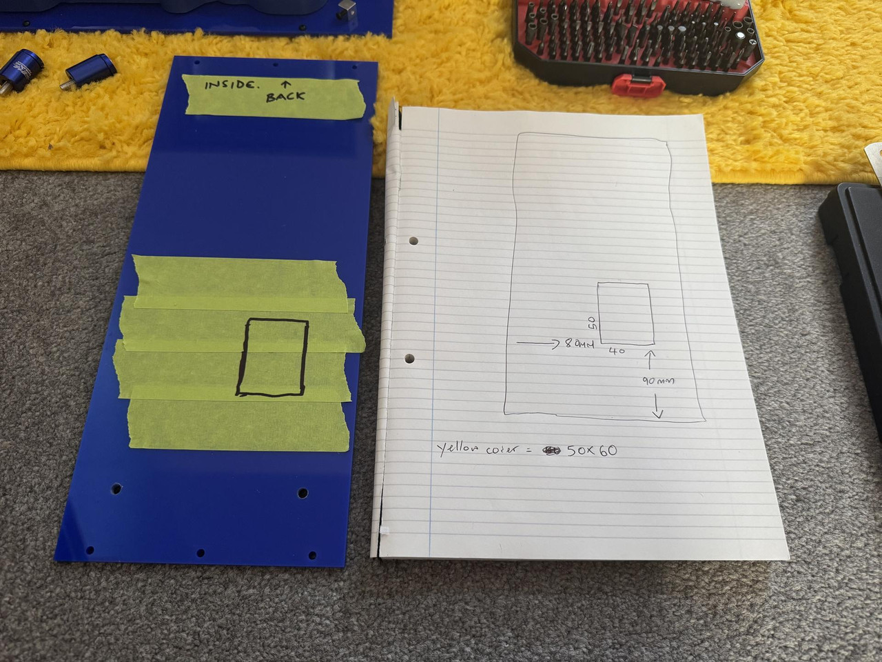

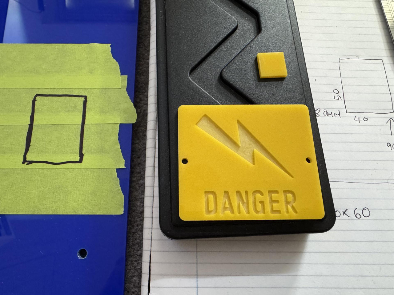

I forgot that when I did the yellow logo insert piece that I’d deliberately left the yellow fixed to the bed as I needed a small square piece. Basically the “tang” on the BC250 is how I need to mount the non business end. I need an 8mm block so obs 3mm + 5mm in blue is spot on, hence why I’d left it stuck down. Setups take about 30 mins and use material. One is free (Amamong envelopes) and the other expensive (Kipp tape).

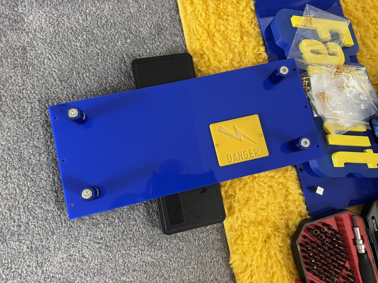

So yeah TL;DR version is I’ve now made that piece, as well as making the cover plate for the floor so the 8 pin PCIE can be connected without playing a game of hand twister.
Tomorrow I’ll cut that access hole in the bottom, then tap some M3 holes to attach the cover to.
I then stuck down the bottom and cut out the access hole. Whilst there I cut the blue piece from the hole itself at the same time. Waste not want not lol.
Drilled two 2.5mm holes to tap to M3 then realised it has been 10 months since I last used the M3 tap which has gone for a walk somewhere. Have ordered two and they’ll come tomorrow.
I’m going to start work on the other side panel tomorrow. Bloody long job that’s going to be !

Done some M3 in Aluminium which made a grown man cry, pinged a good few M4 taps too trying it in ally. Then we realised that the CNC was not outputting the RPM it should have been so while it thought it was turning at the correct rate it was twisting too much for each mm it went down, either stripping the hole or breaking the tap....what a fun few days that was.
If you do plan on trying tapping on the CNC please experiment on a scrap piece first....don't ask how I know OK!
Snapping bits becomes a way of life in CNC lmao.
OK I dropped some M2 in to see if it’s straight. It is, so that’s good.

OK the longest “negative “ I’ve ever made. Just over four hours.
Let the cursing begin in earnest tomorrow when it starts flinging tiny pieces to be lost forever lmao. I have a feeling I’ll be running it more than once!
You're going to cut out all the little inlay pieces separately? Yikes. Safety glasses Knight's helmet with visor at the ready then!
Might not work for this one but is there another way of doing it without separating all the bits off? For example, in this situation you could cut the mirror image out of yellow but not cut all the way through. When finished, drop the lot into the negative space, stick it down and then machine the rest of the yellow off the top. Downside is the top of the yellow wouldn't be shiny...but chunks of your walls, furniture, ceilings etc also wouldn't be yellow! :D
