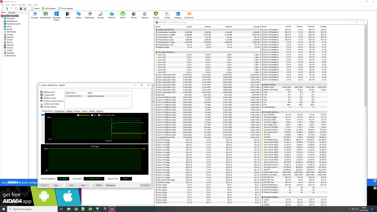

I have a Noctua U14 S and idle around 30c. Max temps i’ll run AIDA64 stability test now with all cores running 4.7Ghz

Sorry to jump on in. My 5800x is Auto PBO and max load it gets around 79c, my question if I may kind sir is what voltage did you start at and what are you now testing at? I'm feeling 4.7 and a decent long term voltage will he key for lower temps with a NH-D15![]()
I'm getting an all core boost up to 4.75 in AIDA with temps topping out at 77.5c on a wraith prism.Is that with AIDA64, R20 or something else stability testing?
I was 10 runs R20 stable (max 76c) but unstable for AIDA64 at 4.7ghz all core after about 2 mins.
All core in r23, r20, cod mw & cyberpunk stable at 1.2375V in bios (1.225v with droop) gaming max temp at 4.7ghz 1.2375V bios was 57c
AIDA64 PBO auto is 86c max so far, all cores levelling out at around 4.5Ghz
In short, AIDA64 stability test kicks the crap out of the CPU, maybe an unrealistic test (stress cpu, stress fpu, stress cache)
edit - up to 88c in AIDA64 on PBO auto (default) that’s very close to the 90c rated tdp on an AMD recommended cooler
