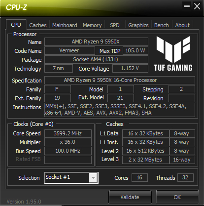

Hello, sorry if I ask something that may have been already answered: if I buy a 5950X from the OC UK store, can I ask for it to be a B2 stepping ?
Just for history purposes, at this time (due to the pandemic and remote work) CS said that unfortunately they can't guarantee a specific revision, unless that specific revision is directly stated in the product description on the website.
You can check with CPU-Z. I have a value of 2 under stepping.
