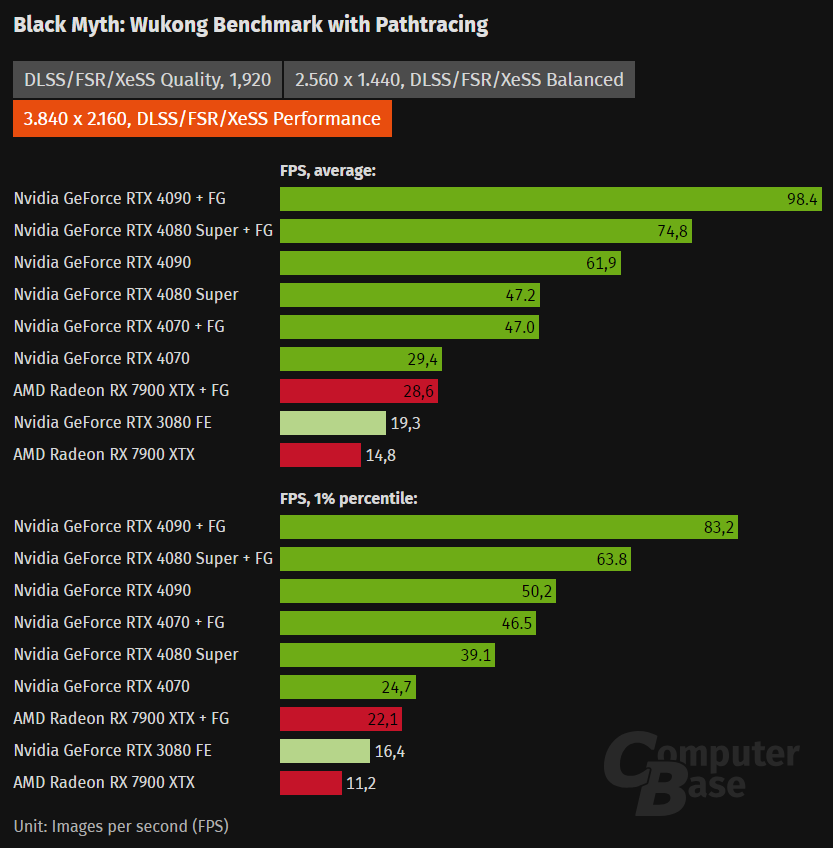

Are you surprised? The Full ray tracing option is literally for Nvidia so optimised for RTX. When you go to this option it says Enabling Nvidia full Ray Tracing. We know AMD 7900xtx is at 3090 levels of RT yet in this it's not even close. AMD and most Nvidia users will pretty much have to settle for the standard RT that can't be switched off. In this mode it's easily playable and still looks decent.![]()
Black Myth: Wukong Benchmark angeschaut
ComputerBase hat sich den Benchmark zu Black Myth: Wukong genauer angesehen und stellt einen ersten Vergleich der Pathtracing-Grafik an.www.computerbase.de
RDNA 2 needing FG to keep up with competing gpus without FG! Yikes!![]()
I am not saying the hardware is great at RT but the option literally says Nvidia so what makes you think it's not optimised for RTX cards.People need to stop saying RTX optimised, if any other card could do RT or PT properly then they'd get just as good performance.
The only difference here is up to 10fps with path tracing thanks to ray reconstruction which only RTX cards support right now, will AMD support it some way in the future? Who knows but the hardware isn't up to the task with any other cards today that's what it boils down to not that it's somehow only optimised for RTX cards because RT and PT at their core are just DXR API functions in these games which is a universal standard for n whatever cards can handle the performance hit of real time ray and path tracing.
By saying it's RTX optimised assumes that AMD stand no chance at all but in actual fact they didn't care to put focus on RT hardware for so long.
It's still early days for Intel though.
So yeah it's not an optimisation issue, it's a hardware issue, AMD just didn't care and fell behind two generations of RT advancement.
Yet the more RT there is the more Nvidia cards that can't keep up either. As you keep saying there is RT in this game by default and the AMD cards seem to do fine. I am not sure what the RTX branding has to do with it. I said RTX cards which is Nvidia cards that are designed with RT in mind. If i just specified Nvidia cards then that would be wrong.Yup, nvidia nailed it with their RTX marketing! RTX is purely just nvidias branding name for their features. AMD is performing exactly where it should regardless of it being nvidia or amd game when it comes to RT grunt. I think the only exception we have had is FC 6.
It's simply as DF/Alex have said all along, the more RT there is, the harder AMD fall because of their lack of RT hardware grunt.
In Alan Wake the 7900xtx matches the 4070ti super with RT enabled and in plaque tale more 3090 in the Techpower results. So UE5 does not seem to be the issue.It's a common trend among many UE 5 titles now regardless of nvidia being involved, 7900xtx is barely beating a 3090 and sometimes matching a 3080 in UE 5 with RT especially hardware RT.
Any how if an option in any game says Nvidia, through years of experience it's probably going to tank my AMD card and i don't really blame NV as they put in the work most likely. Yet i don't think it's a great example to show how bad AMD RT is as it's not the norm.
