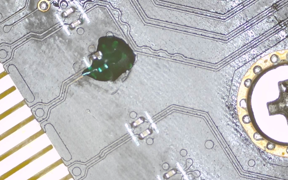

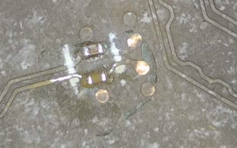

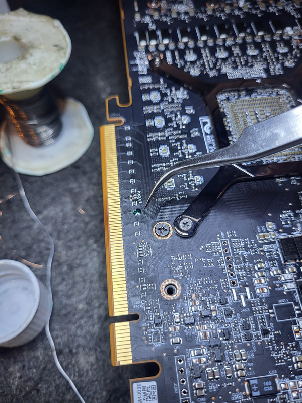

@wookiee87 - got around to sorting that cap tonight...
The bottom trace was ripped clean off and the top trace was lose... manage to grab a cap and get the top back on and looking half decent.. then ran a jumper for the bottom missing trace, I scraped away at the mask to check the vias and where they were going so I could test the lines out...
Masked back up so the cap doesn't fall off again as it will if not masked down.
I shall give it a proper test tomorrow!
Many thanks for the update and tackling the damage, not a easy task given how small the componets are, i didnt think the other smd was damaged too, but with the right tools which you have reveals the truth, i'll say it again a HUGE thank you for your help.
You the MAN Vince
