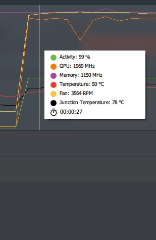

There we go, proof it can be overclocked and undervolted and the HBM also, I KNOW there is a dip there, it needed slightly more mv than i gave it but its 1:30am and i will carry on tomorrow.
Point is, the memory doesn't go down to a locked 800mhz, it stays at 1150 for me 1245 for @Vince
And I can make the core lock at a much higher mhz which gains scores in benchmarks.

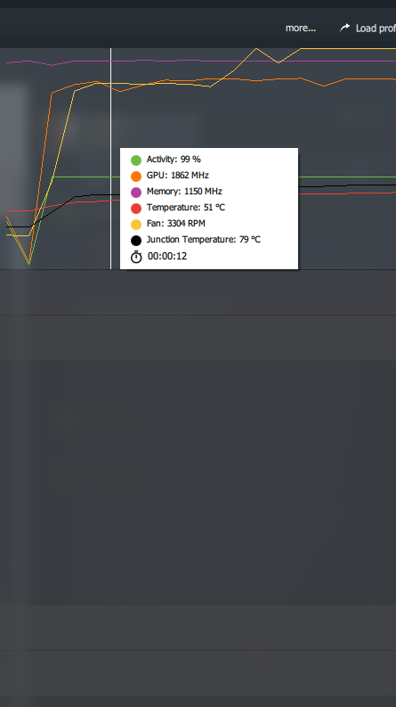

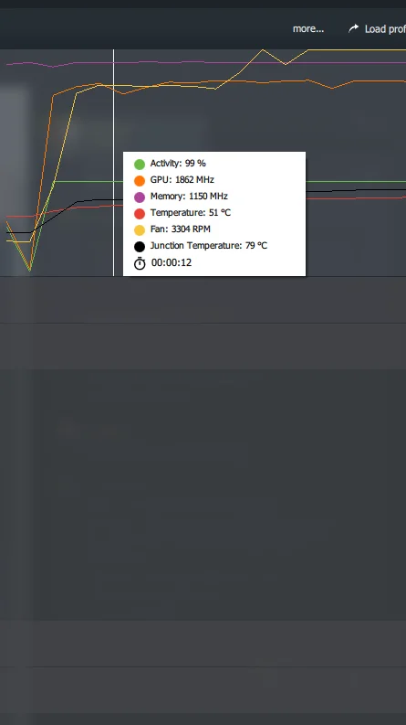

Ah the old p3 state bug, just like vega has.

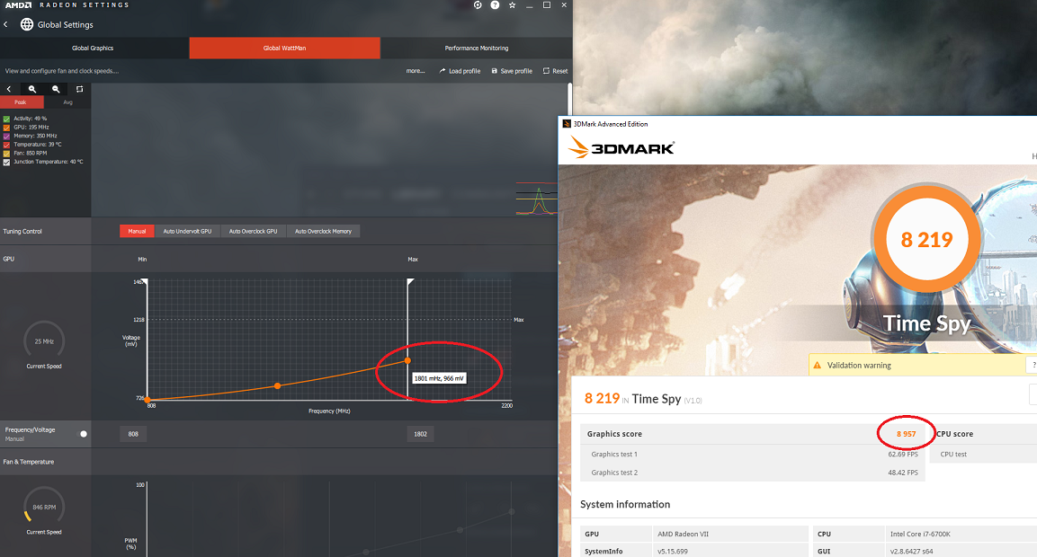

I get a timespy graphics score of 8957, at stock gpu/memory but with 970mv underclock. My overall timespy score is low due to having a 6700k quad core:

3300-3500 rpm on the fans? :eek:
Did you have to bolt the tower to the ground to stop it hovering its way out of the room?

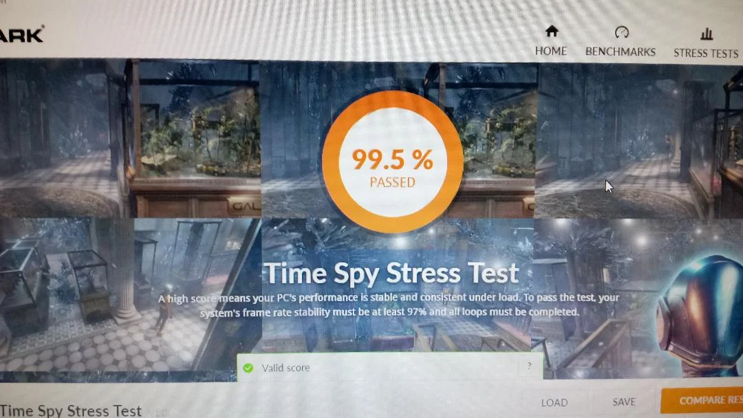

I used 973mv on my card which was fine. What i suggest people do is use Timespy stress test (the most boring 15 or so mins of your life lol) as this gets the card warmed up. With the very low undervolts on air I've seem they more than likely to crash after some screen flickering during the test.
https://www.3dmark.com/tsst/382744
